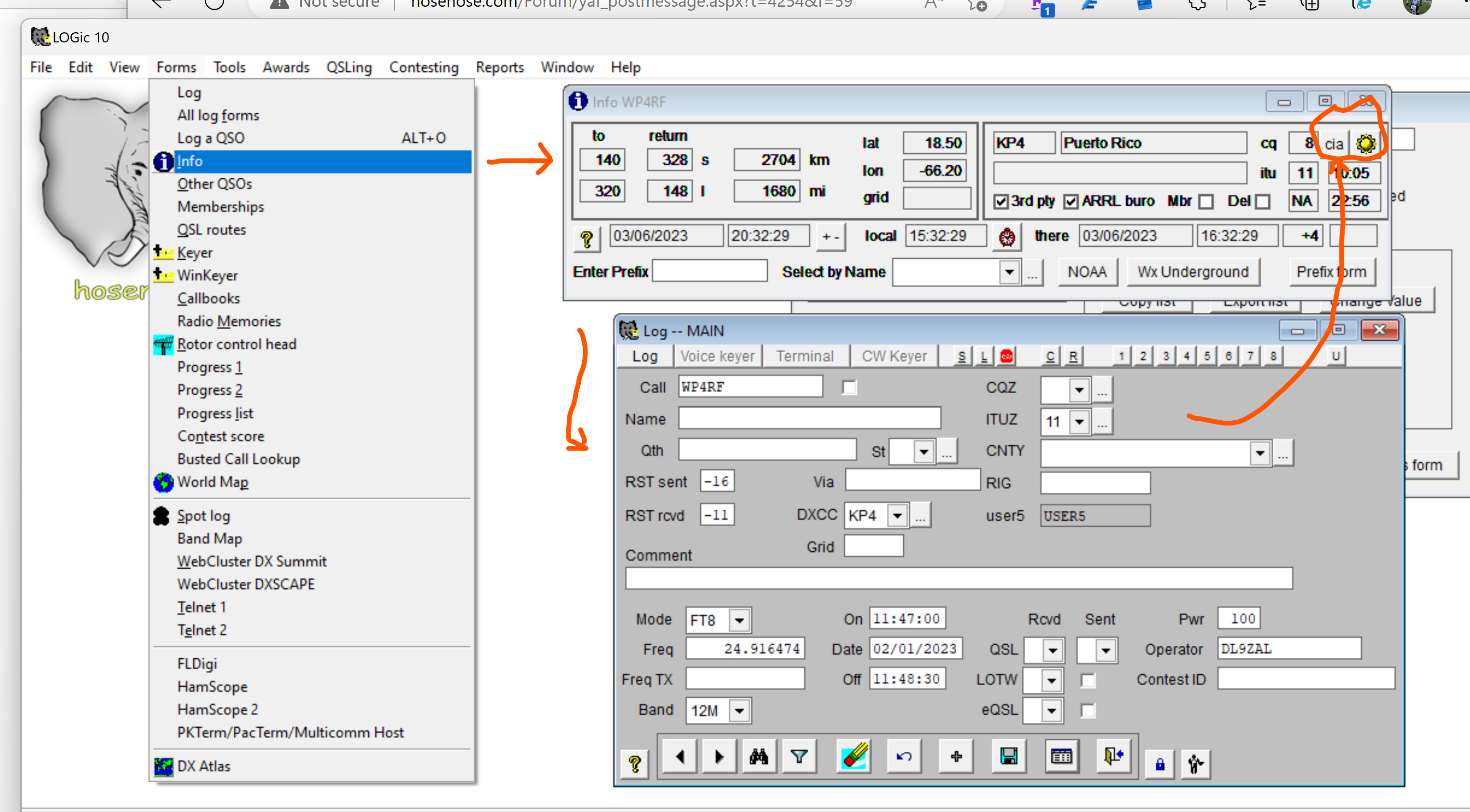

#7 Posted : Monday, March 6, 2023 3:37:50 PM(UTC)
No problem.
Attached is a screen shot with the Info window showing. Open the info form. It should appear. It will probably be blank. Click the log form to fill in the Info form. Or select a country from the dropdown. Then click the CIA button.
