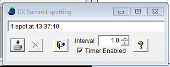

Whichever webcluster you have open should be minimized in LOGics desktop, just restore up. Mine is set to DxSummit, its minimized in LOGics desktop at the bottom far left screen. The pic attached is what it looks like when restored up.
Maybe check also in the Spot Log Options tab to see what the spot level is set to, it may be minimizing the number of spots displayed. Also look to see if any Pre filters were set.

I can tell you where mine is....I use one of the "default" offered clusters (DX Summit) which you can select by going to the Forms tab, select "Webcluster for DX Summit" and it places a minimized DX Summit window at the bottom left LOGics desktop. If you maximize it you will see the same as the pic attached above where you can make changes to the interval. Hope that helps.
