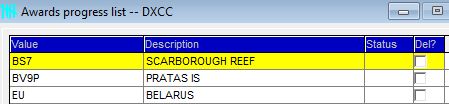

When I run my DXCC award report, it shows I need EU (Belarus). I came across EU7DA on 17 meter FT8 last month and worked the station. I received the LoTW confirmation today but EU is still showing in my report as needed/not worked. What am I missing? What do I need to do to have EU count as worked and confirmed?

I checked the following:
Tools > Setup > Log Fields, spotting and awards tracking > DXCC: Is a QSL from Logbook of the World OK for this award? (This is checked)
Awards > Update Awards Progress Info: Processed 22400 QSOs, no rejects no reconciliation needed.
EU is still showing as Unworked in the DXCC Progress list report.

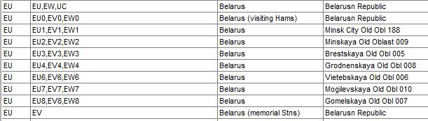

#10 Posted : Wednesday, July 17, 2024 8:03:14 AM(UTC)
Originally Posted by: wa4pgm Go to Quoted Post
Vin,
Just a thought, not sure it'll help but maybe worth a look.
Check the Prefix Table to make sure EU7 is still listed.
73 Kyle
Hi Kyle,
Yes, EU7 is listed in my prefix table along with several other EU prefixes.
LOGic EU Prefix list.JPG (35kb) downloaded 127 time(s).
