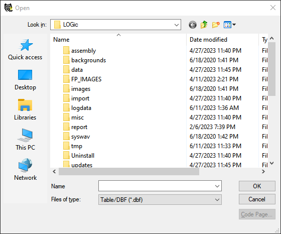

When running the Contest Summary with Multiplier report I get a window pop-up that is looking for some database file, pic attached. It takes hitting the ESC key on the keyboard about 15 times before it finally asks if you want to cancel the print job.

***Just found that running any report pop's up that same window looking for some file to open.....ugh.
Including the log report log.rep?
If that is the case, the problem is specific to your installation. Let me know and I will dig thru the code. MAYBE try reinstalling the latest update on top of what's there. If a file got deleted accidentally that will fix it.
If the log report is OK on your end, please give me another example. Are the problems all with contest reports?
Printing to screen seems to work.
At what point in running the report does it ask for the .DBF file?

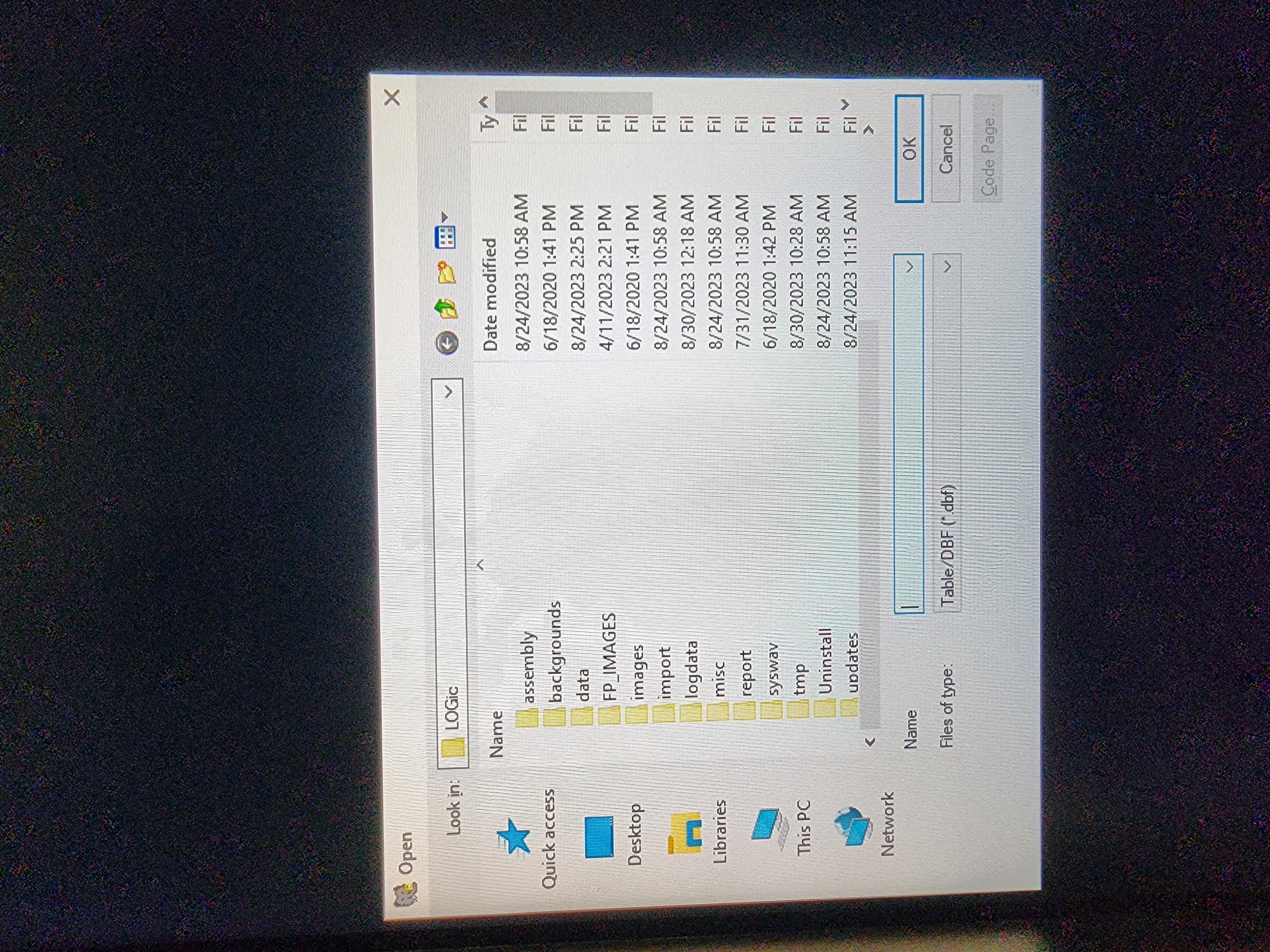

I accidently went to print a second multi-page report and LOGic locked up, stuck in the screen looking for a .dbf file. Had to Cntrl-Alt-Del to get out of it. Any chance of this getting fixed ??

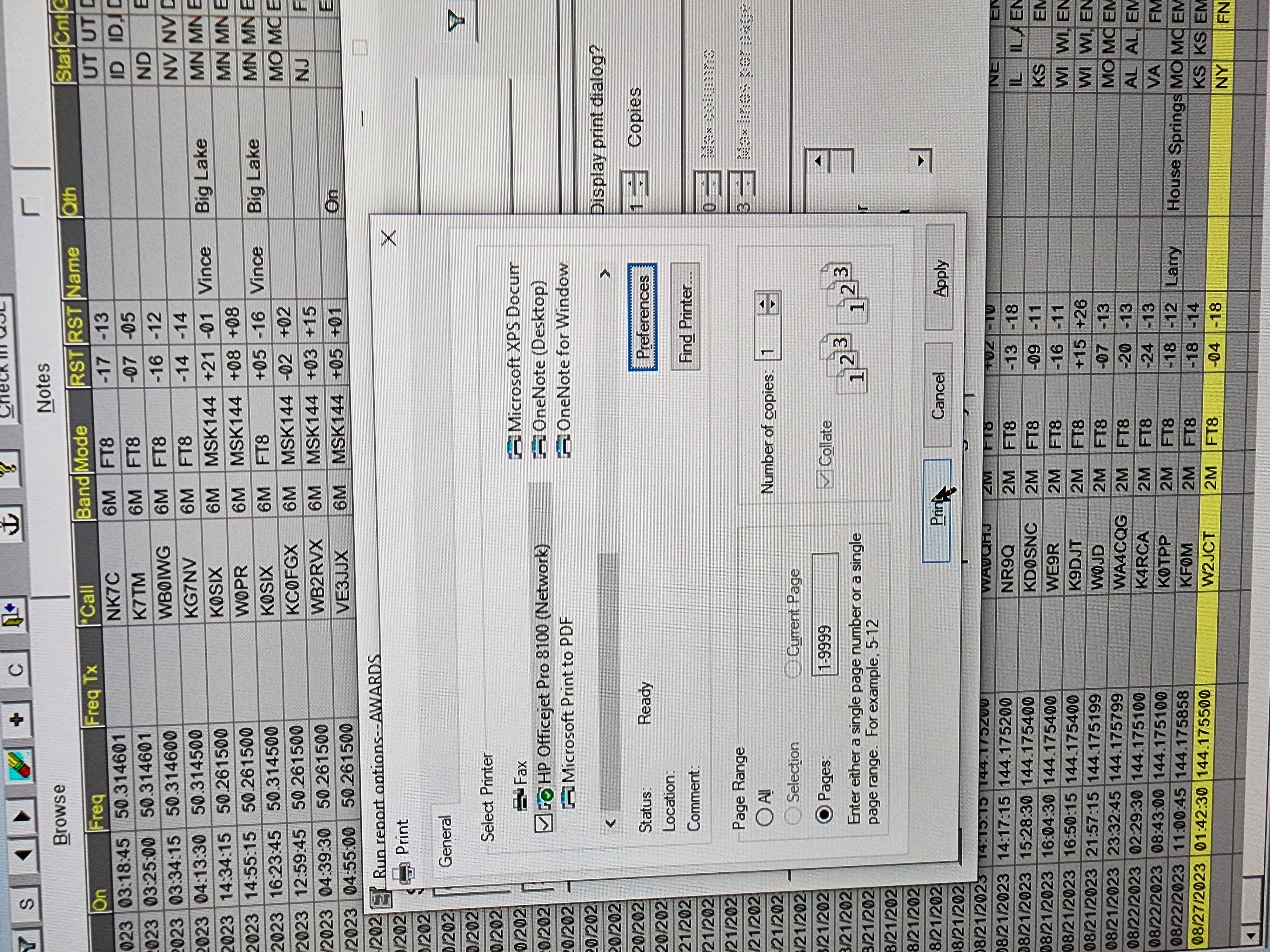

When I print (to printer, no preview) the first report prints fine and all seems good until I print a second report which immediately pops-up a LOGic open file window after you click on PRINT in the print dialog box.
Running LOGics native Awards report.

Tried the newer FoxyPreviewer and same result. The first time I print it prints without issue, second time the LOGic Open file window pops up after clicking PRINT in the printer dialog box.

Sadly, no difference with the new (old) report. The MS Print to PDf I think I tried some time ago but they have dummied it down so much it sucks at formating text correctly and in general cant even display a simple page layout consistently. I guess I'll have to change my printer settings to force it to by default print double-sided before printing any LOGic multi-page reports and hope to remember to change it back when done. At least that way I can print from inside the previewer. I wonder why the FoxyPreviewer doesnt support double-sided printing, one would think it a basic and common feature Confused.
I did notice if you leave the Run Report Options window open after printing and print it again it will print it again and again without issue. Its like once that window is closed and then re-opened for another report is when it pops up the open file window instead of printing.
Also when trying to print the second report and getting the LOGic Open File window pop-up the windows printer que showed a print job but it just sat there like its trying to spool but never does. Instead of Cntrl-Alt-Deleting out of LOGic I left the Open File window and the printer que window open and after about 3 or 4 minutes the printer started to print but only a partial page and it never ejected till after I killed the print job. Not sure if that helps any.

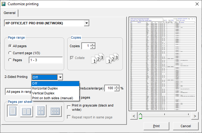

The latest Foxy Previewer Beta release v3.00.269 (2024Feb18) includes a working 2-sided printing option. You can now select duplex printing from Printer Preferences within FoxyPreviewer. The old duplex printing option was Manual only but now is called 2-Sided Printing with a drop-down where you can select "Off", "Horizontal Duplex" (flipped on long edge), "Vertical Duplex" (flipped on short edge) or the original "Print on both sides (Manual)".
FoxyPreviewer_v3.269 Beta-20240218-SetUp7.png (124kb) downloaded 145 time(s).
