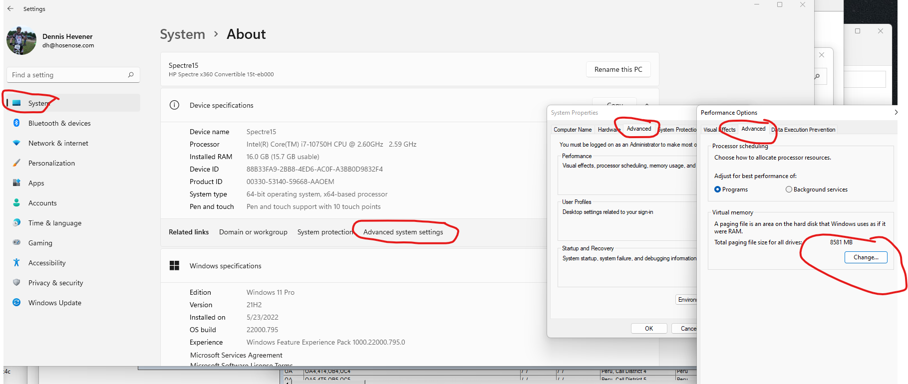

When I say "I have seen that before", I am referring to the delay, not insufficient memory in insufficient stack space or any other error. How much RAM do you have?
Check your paging settings.
