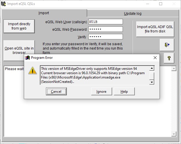

Hi Dennis

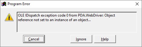

When I try to import from EQSL, I get the error message shown in the attached Doc 1 and Doc2 files. When I hit cancel, I then get the error message shown the attached Doc3 file. When I then hit cancel, Logic shuts down completely.
I am using the last version of Logic 10.0.3
This issue just stated yesterday after update to windows 10
Thank you for your help
Steve, NU1B
#2 Posted : Wednesday, November 24, 2021 10:34:01 AM(UTC)
Please reinstall the LOGic 10.0.3 again. Please do so even if you have already installed that. That should fix it.

Hi Dennis
I verified my copy of E#dge was up to date and reinstalled 10.0.3. That fixed the problem
thanks for your help
Steve, NU1B
