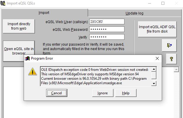

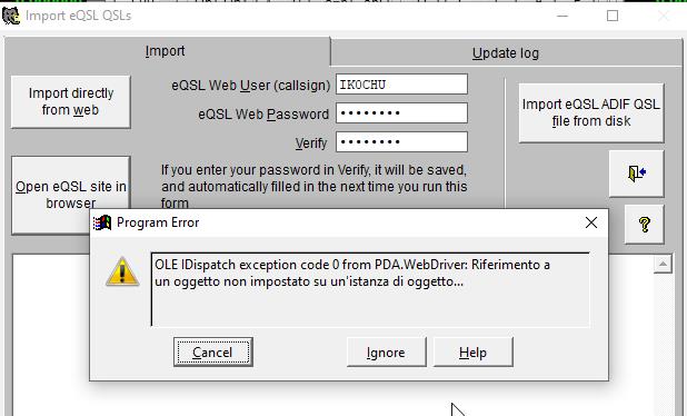

strangely last night while updating the log I could not download the data from eqsl. I also tried backing up to a laptop and was able to transfer everything. I noticed that the problem in the Desktop would be in the fact that EDGE no longer opens the working window for the images of the eqsl and reports the error that I am attaching to you. Maybe I accidentally closed the dialog box and it can't reactivate anymore.
I uninstalled Logic on the Desktop and reinstalled with the latest licensed version 9.20.exe which I upgraded to 10.0.3. I hope I did it correctly assuming I didn't have to install intermediate updates. The installation is okay but the eqsl problem persists. What should I do? Do we need to intervene on EDGE ???
Thanks for your help, I'm stopped at the moment so as not to create further problems.
Mauro IKØCHU
#2 Posted : Monday, November 22, 2021 9:41:43 AM(UTC)
Sorry for the problem. You need to update Edge.
https://www.hosenose.com...2_WebDriver-errors.aspx
#3 Posted : Tuesday, November 23, 2021 2:01:46 PM(UTC)
Also, please reinstall 10.0.3. Do that first.
