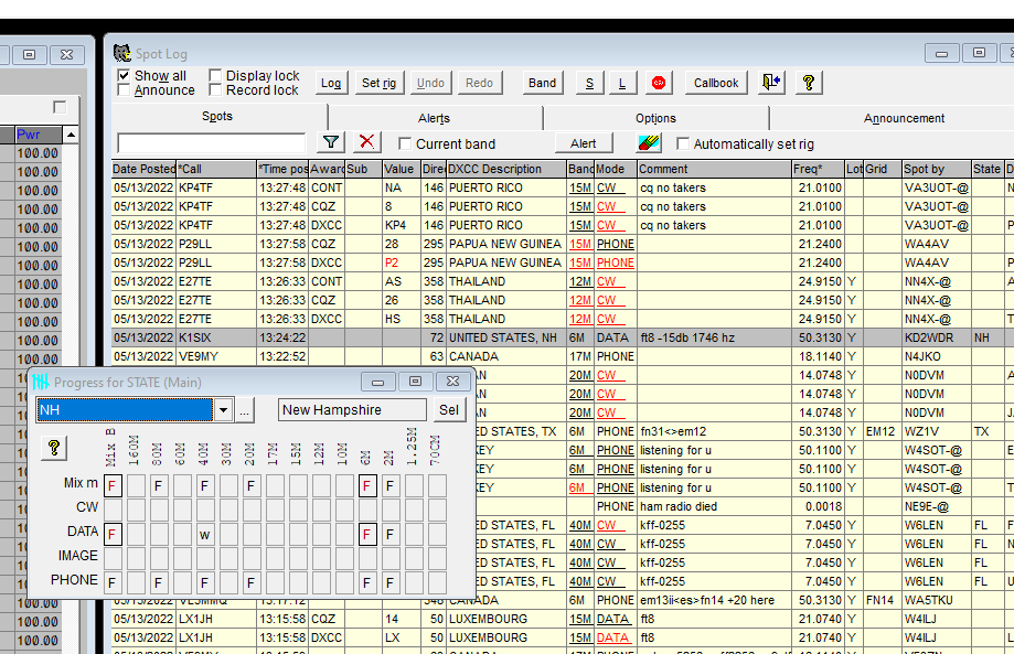

A single click on the spot will show State Progress as long as the Spot actually included a State. In the Spot Log window navigate to see the State column, if it has a state in that field then a single click on the Spot will show progress for State. See attached example that shows the result of a single click on the spot, at the far right of the spot log window is the state column in this case its showing NH and the Progress for State window shows the award progress for NH. A single click will NOT launch a Callbook look-up.
