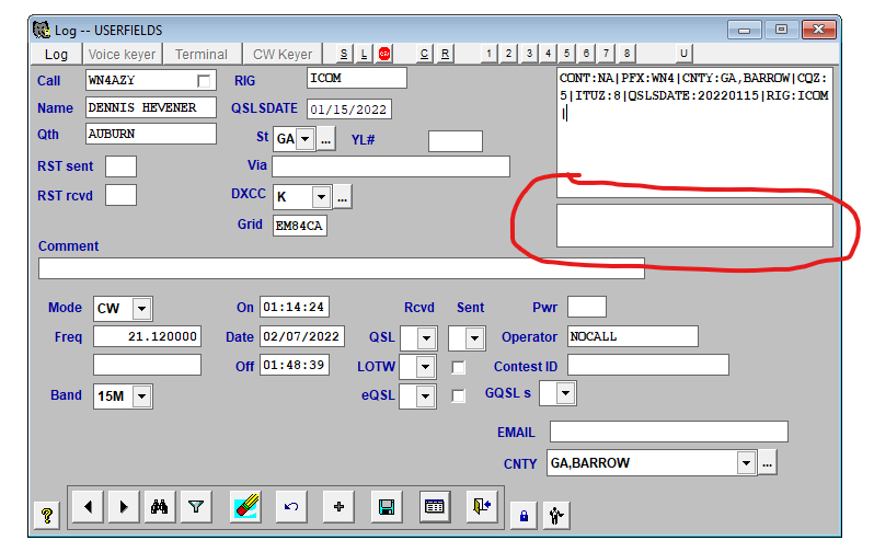

I tried changing the QSLSDATE on one of the records and there is good news and bad news.
The good news is that I can fill that field in but when I click the disk icon to save it the date does not appear in the Qslsdate user field.
But it is displayed in that field in the log window. If I exit Logic and restart it the QSLSDATE field on the log page still has the date
I entered but it's still not in the Qsldate user field. See attached file.

The good news is that I can fill that field in but when I click the disk icon to save it the date does not appear in the Qslsdate user field. But it is displayed in that field in the log window. If I exit Logic and restart it the QSLSDATE field on the log page still has the date I entered but it's still not in the Qsldate user field. See attached file.
Sorry, I see nothing amiss from your screen shot or your description. QSLSDATE is a user-defined field. It is getting saved.
Please open the USERFIELDS log form and look at that QSO. I think you will see what is going on. QSLSDATE will be there. The new USERFIELDS screen should have two userfield areas. When the first fills up, the second will start getting filled. It is blank on my screenshot, because I don't have enough data to need the second.

I found that the QSO I was able to enter the QSLSDATE on the log screen but did not show up in Browse window. I brought that one up in the log screen and did Log->Fix QSO and that did it.
