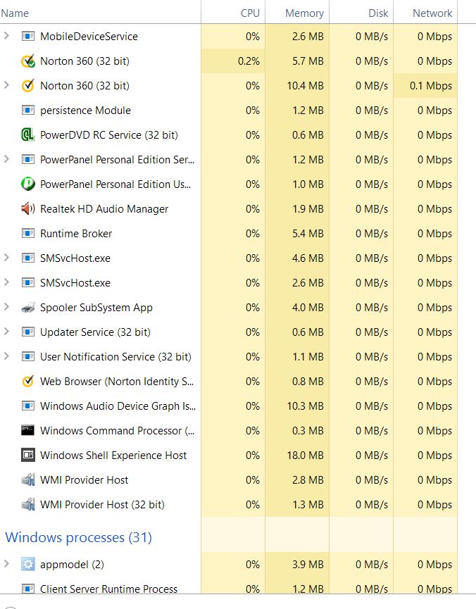

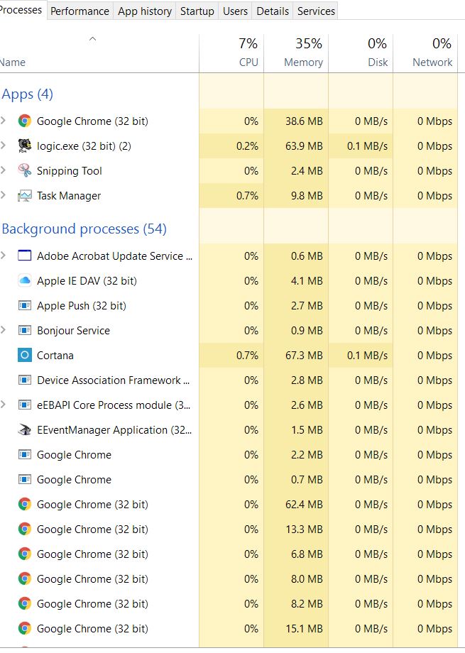

Hi Dennis
Thanks for the fix on the clock crash. Here is a snap shot of what else is running.
Mike

Thanks for your call and posting the task manager screen shots.
Could you also send me the text of the error messages in the event viewer log? There were two for each crash -- one from LOGic and one from .Net.
