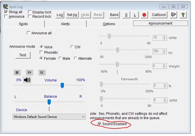

I found a difference between the older laptop using Windows Vista and the Spectre laptop using Windows 10. On the older Laptop, Logic closes when the error message is closed. Closing the error message on the Spectre does not close Logic. I was able to go to Spot Log/Announcement. At the bottom of this tab, where it shows Device, the drop down menu shows: “(sound not available)”. There was no other selection available in the drop down menu. There is no Sound Enable check box, as shown on the graphic file attached to your reply. Your graphic file shows that you have selected, in the drop down menu: “ Windows Default Device Selected”. I do not have that choice. Note that the Spectre does not yet have any serial ports defined or connected.
After seeing your graphic file and the Announcement tab on my Spectre laptop, I suspect that if I could have gotten into Logic on the older computer, I would not have had the ability to enable or disable the sound. That computer probably shows “sound not available”. I am wondering what the difference is between your Spectre Laptop and mine. Do you have a USB connected sound system? Or, if you had one connected at one time, maybe the drivers are still loaded and presenting a different sound system capability in your laptop. Or, possibly, with my inexperience with Windows 8 that was loaded on my Spectre, previously, or with the current Windows 10, I have to do some sort of setup or change in the operating system. If so, I have yet to find it. This problem is getting beyond my pay grade!

I say apparently, as I got the rectangle that had the same title at the top, but no other information inside.
Try moving the empty error box a little. That may cause it to paint.
Ok, then the interim update is not installed. Download logic.exe from here, then copy it to c:\program files (x86)\logic, overwriting the existing one.

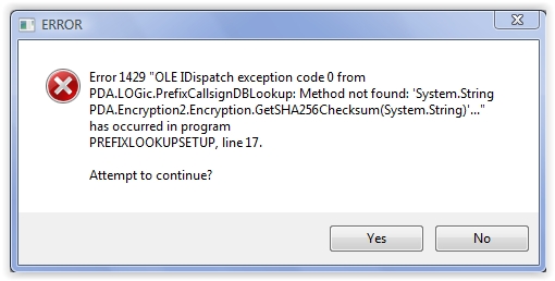

I got Logic to work on my older laptop computer. I tried the logic.exe file, from your separate link, again. I got to thinking about this problem and remembered that I did not try rebooting Logic. This time, I tried closing or continuing through the first error message. Then, I went through about 2 more error messages with the last error message closure abruptly closing the program. I rebooted Logic for the second time. I went through about 5 error messages, with the last error message abruptly closing Logic. I rebooted Logic for the third time. This time, when I closed the first error message, Logic booted up completely. It has the Sound Enable check box in the Spot Log/Announcement tab.
Now, each time I boot up Logic, I get the same single error message, as follows:
Error 1429 “OLE IDispatch exception code 0 from
PDA.LOGic.PrefixCallsignDBLookup: Method not found: ‘System.String
PDA.Encryption2.Encryption.GetSHA256Checksum(System.String)’…”
Has occurred in program
PREFIXLOOKUPSETUP, line 17.
Attempt to continue? Yes No
When I tell the error message to Continue, Logic boots up completely. Logic seems stable and everything I have tried works well. I can log into the ARRL LoTW. I get this error message regardless of whether the Enable Sound box is checked or unchecked. Logic also works with TRX-Manager connected to my transceiver and to Logic.
I checked .Net within Turn Windows Features On or Off. Under Microsoft .Net Framework 3.0, the box XPS Viewer is checked on my old laptop computer.
I have not tried anything further with my Spectre Laptop computer. I can put up with the error message for this temporary use of Logic on my older Laptop computer. If you have a suggestion on how to cure it, I am willing to try it, such as I have not set up something correctly within Logic.
Thanks & 73,
John

Ok, that error means that one of the .Net DLLs that LOGic uses is the wrong version or missing altogether. The lookups of the new CTY extraneous calls database is probably not working.
I could send you the .DLL, but instead of that I will make a whole new install with the latest version and get that to you. It will take a few days unfortunately.
Sorry for the problems. It shouldn't be this difficult.

OK, thanks, that is why the check mark in the Enable Sound check box went away after I checked it and received the error message. You designed that way!

I confirmed that .80 does indeed automatically disable sound upon certain soundcard-related errors as .79 does. However, you probably need to uninstall the SlimDX DirectX library from Control Panel/Programs and Features for this to happen. There are separate vesrions of SlimDX for .79 and .80. You were probably seeing what you were seeing because .79's SlimDX was uninstalled, but .80's wasn't. I did fix a sound card error in the last iteration of .80, so unplug the Timewave thing or any other external soundcards whose drivers are questionable, and test using the computer's internal sound card again. If no go, then uninstall the SlimDX and you can get back into the program.
I removed the .80 beta from this thread and made an official post here:
