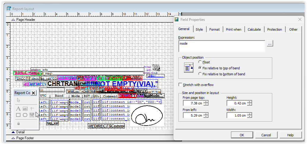

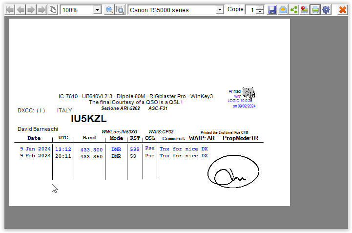

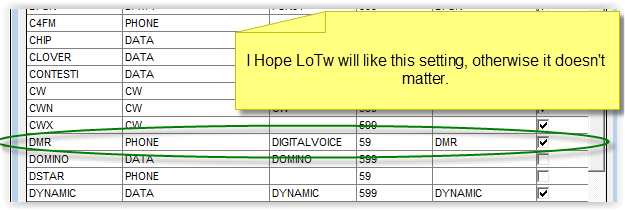

#5 Posted : Saturday, January 27, 2024 7:06:11 AM(UTC)
thanks for your intervention, I tried with the iif( commands but as a syntax they work but it doesn't write me anything in the MODE field. So I chose the simplest way by putting DMR as MODE and I modified the configuration by putting DIGITALVOICE only as adif transfer.
The screenshots necessary for your evaluation are attached. As you can see, the QSL prints very well and if when I transfer QSOs in DMR to LoTw it doesn't accept them I will deal with it without any problem whatsoever also because I don't think there are, and have any reason to exist, awards in this sense. I do it only to satisfy the needs of some OMs who like it and request it especially on Qrz.com to which I transfer the data from my Logic without working on it further.
Thank you always for your availability which serves as an incentive for me to understand more about Logic to exploit its potential.

#7 Posted : Sunday, February 4, 2024 3:03:50 PM(UTC)
Ok Dennis, at the moment it seems that everything is working as it should both for printing QSLs and transferring them to Qrz. As soon as I try to transfer a QSO in DMR on LoTw I will only have to check if the modification to the MODE DMR record in the transfer to ADIF field with the string DIGITALVOICE is in fact accepted without giving errors. In this case then the problem is solved. I will keep you informed. Thank you.

#9 Posted : Friday, February 9, 2024 3:31:44 PM(UTC)
I inform You that all the mods I made is doing a fine job. The LoTw transfer was accepted and the qsl is OK.
Mauro CHU
