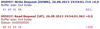

Have got the following information from Rene about how to poll the card:
If the supplier of Logic9 is asking for the commands used to poll the position, just send him the picture I attached in my last mail. This is showing the poll-command in BLUE (AI1;) and showing the answer of the interface in RED (;286).
The picture is in my last update as an attachment , same picture laded twice - my fault

Looks like the picture is gone from my entry in the forum, so I send you a copy by mail.
I also send a copy of what Rene is saying:
Our last tested version of Logic was Logic8. In this version the program did NOT poll the position information from the rotor and therefore could not show it.
Today I installed Logic9 in order to see if this has changed. And yes, it has.
With the Rotor set to:
Driver: HyGain DCU1, Green Heron RT-20 (uses 4800 Baud 2 stop bits), etc.
Baudrate: 4800
Stopbits: 2
Poll: checked
The program is now requesting position information from the rotor, see file attached. The ERC is answering properly with ';aaa' but the position is not shown on the rotor-head. You may contact the author of the program in order to clarify this.
As I mentioned in the forum, neither the rotor header nor the world map is updated, but I can control the rotor to any position from Logic9. Hope this can be fixed.
73 de LA2SL Ulf
Ok, I posted the picture you emailed. Don't know what happened to it -- I looked at it so we know it was there.
LOGic 8 does not support reading the heading from the controller.
The problem is that the semicolon is supposed to go AFTER the heading, not before. LOGic is looking for the semicolon to trigger the end of the packet. It makes no sense to put it before. This is going to be difficult to work with.
Does it always return three digits? ;000 or ;0? ;001 or ;1?
