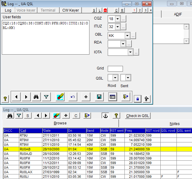

Yes, you have the TAB process correct. Being able to reposition at the "first" entry on the form for the QSL is of great benefit. I installed .57. CTRL-HOME only works if CALL is visible on the log form. Any form for which CALL is hidden - does not respond to CTRL-HOME - nothing seems to happen. On the attached form, CALL normally does not appear - and CTRL-HOME does nothing. If I un-hide CALL, CTRL-HOME functions. Clearly, there are things happening with CALL in the form procesing - other QSOs, memberships etc. If I have to have CALL on the form, I can live with that, but would rather not.
UA QSL
By "speed of typing" I meant - the delay after I stop typing to when the List table respositions based on what I have typed. For JCC, if I type 140 <short pause> 14, the List table moves (when I pause) to "14001" rather than wait for the full "14014" that I wanted.
In the CQZ field. This is a trivial example, but more clearly illustrates the issue. If I want zone 36, but type 3 <short pause> 6, the List moves to zone 3, then zone 6, rather than the 36 I wanted. For zone 33, 3 <pause> 3, the List moves to zone 3, then zone 30. Trivial I know, but for longer fields like JCC, JCG, RBA, WAB etc, the issue is more serious.
It seems that when I pause in my typing, if the pause is longer than a certain length, what I have typed so far, is taken as the input, and the List table is repositioned.
I just set <double-click> speed to as slow as possible, and it seems to have had no affect on the above. I have also adjusted the keyboard "delay" and "repeat" settings which also had no affect.
Ok, I will look at that. It should go to the field that is first in the tab order.

Ok, thanks. Fixed {Ctrl+Home}. Will be in the next update.
#7 Posted : Thursday, May 16, 2013 8:26:16 PM(UTC)
Posts: 3,240
Thanks: 1128 times
Ok, I was wrong about the mouse dblclick time controlling this. They updated VFP to have its own setting for keyboard timeout.
You can set the keyboard timeout for dropdown boxes SETTING the _INCSEEK system variable.
Go to tools/advanced/database commands. To see the current value, type
? _INCSEEK
The value is in seconds.
To set to 2 seconds, type
_INCSEEK=2
Valid range is .05 to 5.5
You can put this command in your startup .PRG in the UPDATES folder where you load your FLL as we discussed previously.
