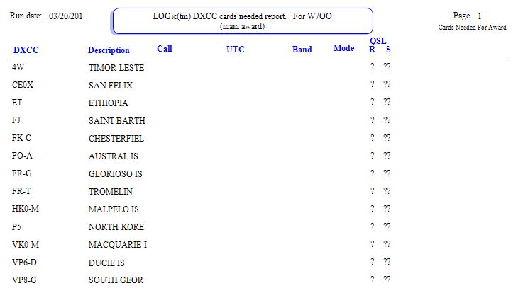

I ran the "All Band and Mode Awards Progress -- DXCC Challenge" report today and don't know how to interpret the results.
Please see the attached file DXCC Summary 3-20-13.
It shows in the summary under Worked No QSL Received a total of 1 card. This is new in the last few days.
When I go looking for the country I worked but have not received a QSL from I can't find it. I also have not worked a new country in the last few days.
Please see the attached file Cards Needed 3-20-13.
It shows no countries that I have worked but not received a QSL from.
What am I missing?
Thanks for the help,
Bill
W7OO
cards needed 3-20-13.JPG (41kb) downloaded 133 time(s).
DXCC Summary 3-20-13.JPG (104kb) downloaded 127 time(s).

The Mixed WORKED - NO QSL RECEIVED means that you will have a line associated with a country somewhere in the report that has only 1 or more Ws on it. No Requesteds or Fulfilleds on any band.
As to why it isn't showing on CARDS NEEDED FOR AWARD -- is that the whole report??? Try running it without the SHOW UNWORKED ENTITIES option checked.

Yes, that is all of the countries needed report.
Here is what I found. Per your suggestion I went carefully through the "All band and mode awards progress -- DXCC Challenge" report looking for a country with only a W and no Fs in it. I found one.
I had not worked it in the last few days (the time period when this happened) and when I went to the "Progress for DXCC" window and put in it's prefix it was there with a W but when I clicked on the W the DXCC window opened but did not show any calls. I then ran an Update Awards Progress and the W went away and the report is now clean.
I have no idea how the data base got corrupted like that but it is fixed now.
Computers are wonderful but occasionally something strange happens.
Thank you again for the help in cleaning up my data.
