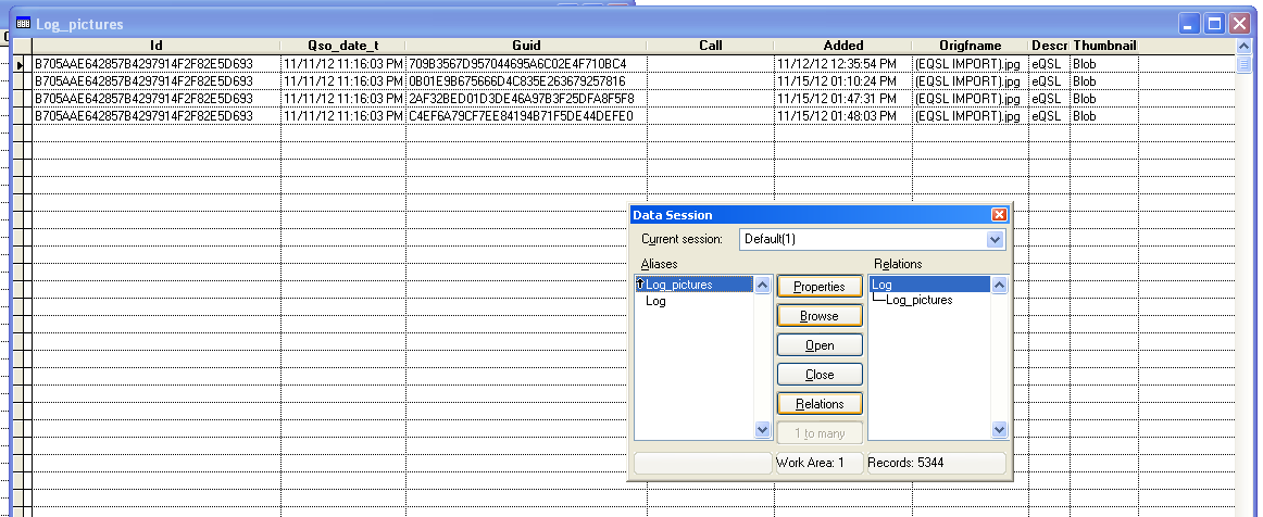

G'Day Dennis,
While working on my lists and QSL cards today I found the attached - one QSO has recorded against it, 4 eQSL images. I found several other cases elsewhere in log_pictures.
The attached images show the offending QSO as I fount them in Logic. And then again on a development system using a Data Session in VFP. I now have a full copy of VFP 9 SP2.
The first entry in log_pictures is correct. The next three are errors. The real QSO for AK7AZ is correct and has a different JPG file name. The images for W4CLJ are duplicates of a single QSO, and the real QSO for W4CLJ is correct, and has a different file name.
My paper log shows nothing particular, as regards errors, happened on Nov 11 (the day the images were added) - except that on that day I downloaded all eQSL QSO images - probably several thousand of them. I used the update for Logic after you corrected the problems with eQSL images.
I am not too worried about it - the log is OK.
How do I fix the extra images - just delete the records from Log_pictures?
I am not in the habit of dragging and dropping images onto QSOs. Images are only downloaded from eQSL.
Peter VK4IU

Sorry. I don't see it in the lst of updates, but I recall some issues with this in the past -- LOGic 8 maybe? I was pretty sure it has been fixed. But this is a fairly recent QSO. How old are the QSOs for the erroneous cards?
Anyway, just delete the erroneous images.
