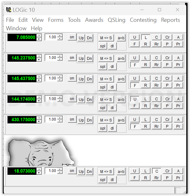

#8 Posted : Saturday, April 26, 2025 10:16:53 AM(UTC)
Posts: 395
Thanks: 61 times
Hi,
everything is back to the initial state.
I wanted to ask Dennis if the informations that is obtained by passing the mouse over the frequencies referring the Description and Port can somehow always be evident in a button under the frequency field with type of RTX and com that it uses for the cat, as shown in the image?
Thanks for attention.
Ciao Dennis de IKØCHU Mauro
