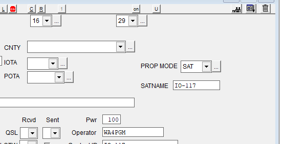

Okay I have Prop Name and SATNAME on my logging screen.
BUT why did the labels for CQZ and ITUZ disappear leaving the dropdown boxes?

They may be just off the form or buried, unlock the logform and try to stretch it bigger to see. Also check they didnt somehow get hidden (click on the trash can in the upper right). How many userfields do you have active in the logform ?? Click on the waiterman and see if CQZ and ITUZ are still associated to a userfield (under the column "Select field to change".

Thanks Brad, I stretched the screen to maximum view and CQZ nor ITUZ is NOT shown. I have tried relocating the field, deleting the field, rebooting computer, restarting LOGic
For as long as I have used LOGic I never looked at the trash can in the upper right. But CQZ nor ITUZ is listed as deleted.
5 userfields are being used. CNTY, IOTA, POTA, and now PROP MODE and SATNAME.
The dropdown boxes for CQZ and ITUZ are displayed and seem to work but the text CQZ and ITUZ is missing.
Yes CQZ and ITUZ are associated with a userfield. CQZ is #6 and ITUZ is #7
This all started with adding PROP NAME and SATNAME, as soon as I did that the field CQZ and ITUZ shifted and the field names disappeared. Puzzling, thanks for your help.

Well I figured it out. It was hidden, I was looking for CQZ and ITUZ and not user6, User7.
