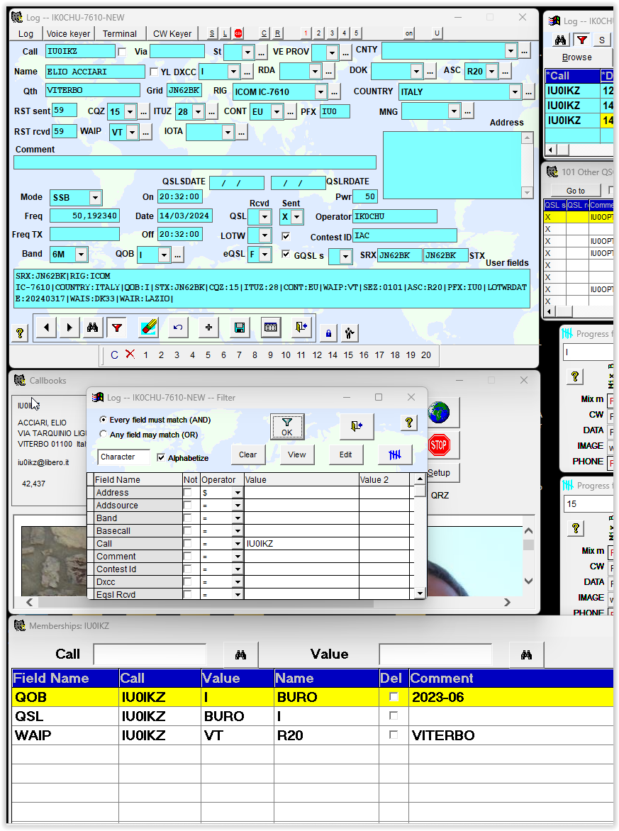

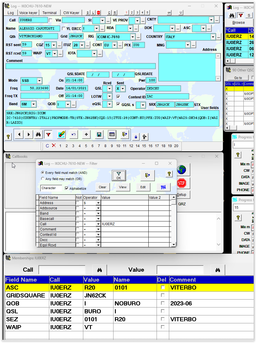

thanks for replay and we are the requested files attachment with notes inside. I hope can help You. I will send You my dbf archive extracted from my actual Logic system.
With new entry members the database must be updated but how have I to do to be usable as the first time I created it?
TIA
73 de IKØCHU Mauro

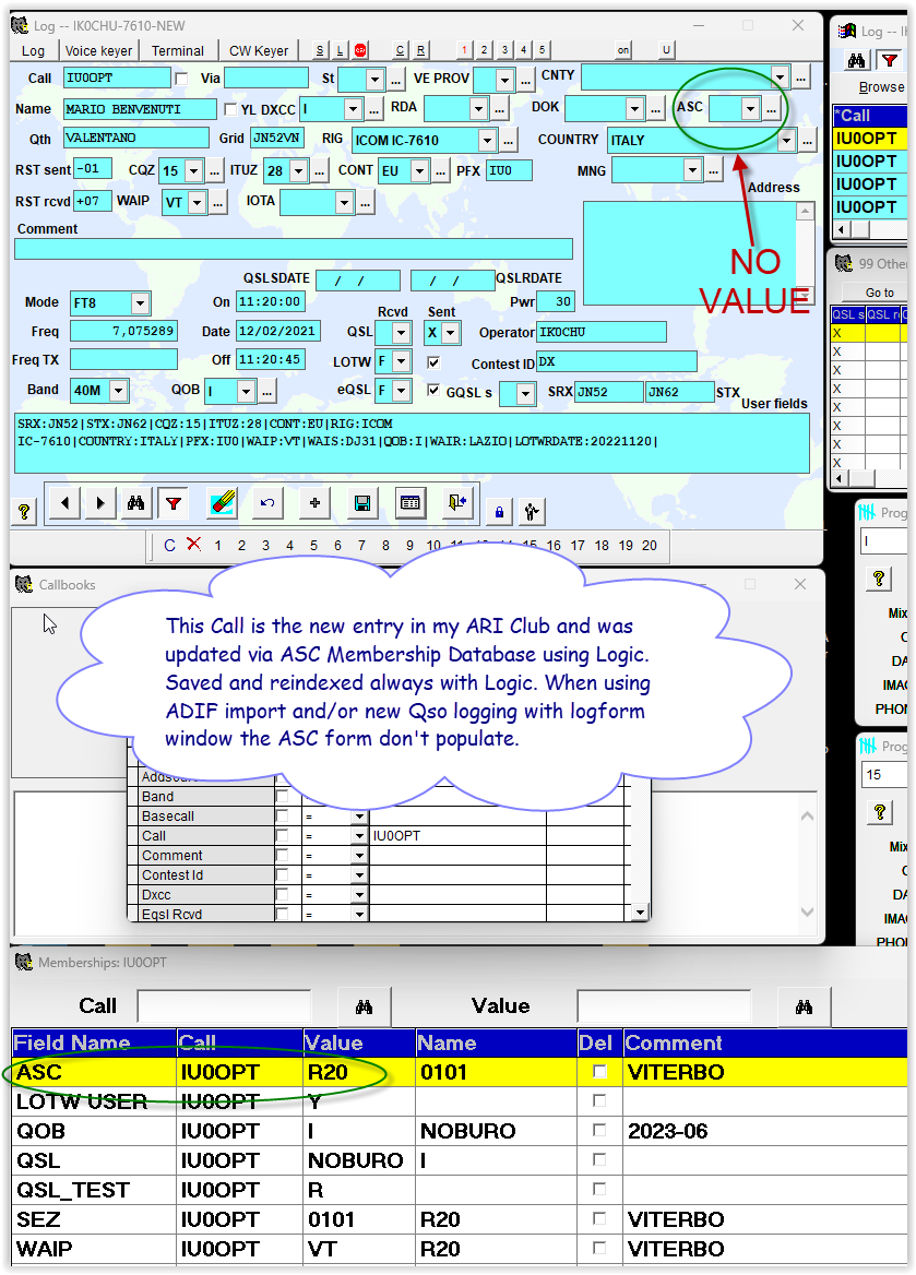

#6 Posted : Wednesday, April 10, 2024 1:29:22 PM(UTC)
I attach what you requested. I believe it is correct, also because it has always worked.
It doesn't work on CALL which I added as new members i.e. IU0ERZ and IU0OPT. I don't understand why and I was wondering how I should go about making updates to an existing database. Thank you.
