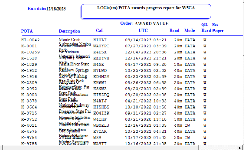

Does anyone know of a way to get a line wrap like is seen with spread sheet fields? I'm trying to get the entire park name to show in the description of a POTA report, keeping the same field width. It actually does the line wrap if you increase the field height, but it doesn't automatically perform the space to move the succeeding lines down. You get a jumbled mess as a result.

Dennis, this is what I'm talking about...start with reports/awards/pota
pota report.PNG (226kb) downloaded 131 time(s).
#4 Posted : Wednesday, December 20, 2023 8:47:06 AM(UTC)
OK, thanks for the photo. I think all you have to do is make the DETAIL band a little higher.

Dennis, that fixed it. Many thanks!
