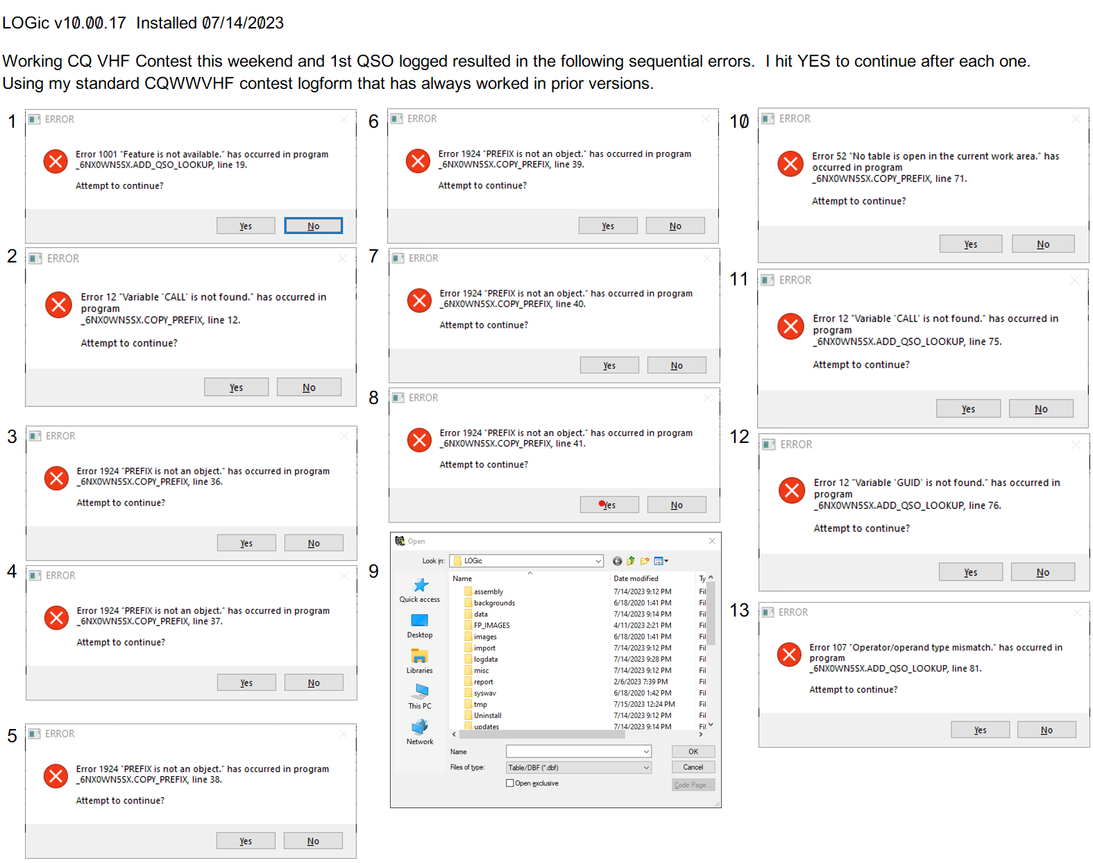

Installed v10.00.17 yesterday and started working the CQ VHF Contest today and immediately got about 13 errors as soon as the QSO was logged via the AutoADIF logging. 1 thru 13 errors in order were;
Error 10001 "Feature is not available" has occurred in program _6NX0WN5SX.ADD_QSO_LOOKUP, Line 19.
Error 12 "Variable 'CALL' is not found." has occurred in program _6NX0WN5SX.COPY_PREFIX, line 12.
Error 1924 "Prefix is not an object." has occurred in program 6NX0WN5SX.COPY_PREFIX, line 36.
Error 1924 "Prefix is not an object." has occurred in program 6NX0WN5SX.COPY_PREFIX, line 37.
Error 1924 "Prefix is not an object." has occurred in program 6NX0WN5SX.COPY_PREFIX, line 38.
Error 1924 "Prefix is not an object." has occurred in program 6NX0WN5SX.COPY_PREFIX, line 39.
Error 1924 "Prefix is not an object." has occurred in program 6NX0WN5SX.COPY_PREFIX, line 40.
Error 1924 "Prefix is not an object." has occurred in program 6NX0WN5SX.COPY_PREFIX, line 41.
Then a file open window pops-up looking for file type Table/DBF, followed by;
Error 52 "No table is open in the current work area." has occurred in program 6NX0WN5SX.COPY_PREFIX, line 71.
Error 12 "Variable 'CALL' is not found." has occurred in program _6NX0WN5SX.ADD_QSO_LOOKUP, Line 75.
Error 12 "Variable 'CALL' is not found." has occurred in program _6NX0WN5SX.ADD_QSO_LOOKUP, Line 76.
Error 107 "Operator/operan d type mismatch." has occurred in program _6NX0WN5SX.ADD_QSO_LOOKUP, Line 81.
After clicking Yes to continue to each of the above, the QSO does get logged.

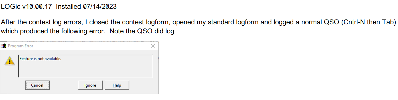

I then closed out of the contest logform and opened my standard logform and attempted to log a normal QSO, Cntrl-N and Tab which immediately resulted in the following error;
Program Error, Feature is not available.
I'm reverting back to v10.00.16 as it had no issues with logging and I'll report back if successful.
UPDATE: Went back to v10.00.16 and all is working....phew !

#2 Posted : Sunday, July 16, 2023 8:42:07 PM(UTC)
Sorry, please download and install again. If still problems, please let me know. .16 will still work.
K8ZM on 7/16/2023(UTC)

Re-Installed .17 and seems fine now. Normal QSO via Cntrl-N & Tab worked fine, also AutoADIF logging working as it should.
Thanks for quick fix Dennis !!
