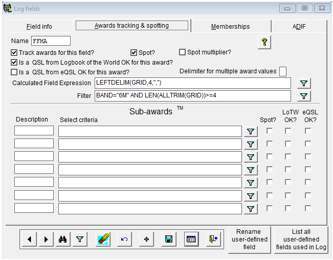

2) So yes FFMA was enabled and in Awards Tracking its checkmarked to track awards for this field, but not sure if the expression for the calculated field in Awards Tracking and Spotting is right, its "LEFTDELIM(GRID,4","), the Filter looks right "BAND="6M" AND LEN(ALLTRIM(GRID))>=4". Funny, now that I think about it I have never seen any spots with sub-award FFMA. Confused

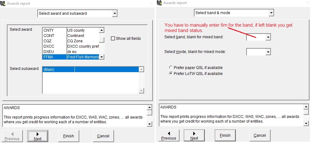

Just to be sure i'm not missing something here is pic.
Handles attachments

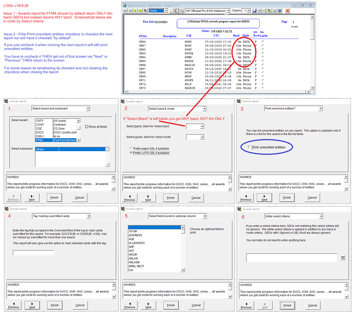

Running LOGic v10.0.26 - Still an issue with having to filter the FFMA Awards report to get results for ONLY 6m. If the band selection is left blank it returns ANY band, see attached.
The FFMA award is enabled and I'm running the native Awards Report, also attached is a screen shot of the calculated field expression.
Any ideas ??
Second issue not as pressing is the "print unworked entities" checkbox. If checked it works fine for the first report. If you print a second report immediately after the first, that checkbox remains checked and clearing the checkbox then printing still prints the unworked entities. You have to clear the checkbox then get out of that screen (either by "Next" or "Previous") then get back into the same screen before it will remember the checkbox was cleared. Its like it remembers it was checked initially but won't clear the checkbox when the report closes
