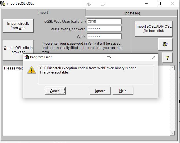

#1 Posted : Saturday, May 6, 2023 9:40:40 AM(UTC)
Billi
Posts: 36
Location: Akureyri Iceland
Was thanked: 4 time(s) in 4 post(s)
I just updated from Logic 10.0.9 to 10.0.16 and get this error message when I try to download from EQSL.
OLE |Dispatch exception code 0 from WebDriver: binary is not a Firefox executable..
I did have LOGIc 10.0.9 installed and there this was ok.
How can this be fixed?
Any help would be good.
73 Billi TF5B

#3 Posted : Sunday, May 7, 2023 9:49:24 AM(UTC)
Billi
Posts: 36
Hello Dennis and thank you for the replay.
If I click the CIA button I do get the same error message.
I am using the latest version of Firefox or at least that is wat Firefox is telliing me.
This has never been a problem befor and if I do go back to LOGIc version 10.0.9 all is ok.
What can I do to fix this?
73 Billi TF5B

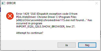

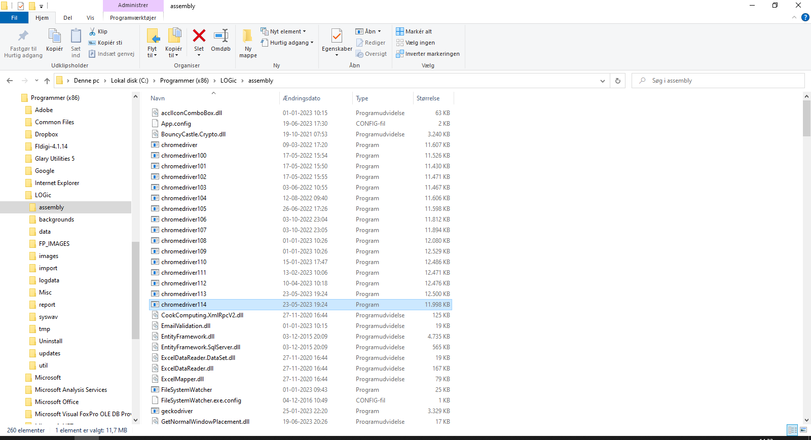

#12 Posted : Tuesday, August 1, 2023 7:43:43 AM(UTC)
Carsten Gjessing
Posts: 50
Location: Denmark
Thanks: 19 times
Was thanked: 14 time(s) in 14 post(s)
Hello Dennis
After installing Ver. 10.0.17, I cannot download e-QSL.
I get the enclosed INFO, and can se in the folder LOGIC/Assemply-folder, that Cromedriver115 is missing.
Can I download it somewhere to fix the problem, or have you to make a new version to include it?
Hope top hear from you.
Best 73 Carsten / OZ4CG
Skærmbillede 2023-08-01 14.29.02.png (9kb) downloaded 144 time(s).
Skærmbillede 2023-08-01 14.32.29.png (125kb) downloaded 144 time(s).
#13 Posted : Tuesday, August 1, 2023 10:41:56 AM(UTC)
Please download .17 again and reinstall. I updated it sometime last week. I just deleted ChromeDriver115.exe, and installed .17, and it reappeared, so I know it is there.
Please note that if I merely update Chromedriver, I will not create a new update version. So in most cases, downloading and installing again will fix it. If not, let me know and I will add it to the latest update.
http://hosenose.com/Foru...r-errors.aspx#post11090
I bolded the relevant part hihi.
OZ4CG on 8/4/2023(UTC)

#14 Posted : Friday, August 4, 2023 7:15:20 AM(UTC)
Carsten Gjessing
Posts: 50
Location: Denmark
Thanks: 19 times
Hello Dennis
Thank you for your quick reply!
I went to the download site and noticed a new version (#18), and after download all is OK.
Thankyou again, Dennis!
All the best 73
Carsten / OZ4CG

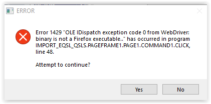

#19 Posted : Monday, September 11, 2023 9:20:49 PM(UTC)
Posts: 21
I downloaded and installed the 64 bit gecko driver from the link you supplied. I use the 64 bit version of Firefox. There were different version dates between the version I was using and the version from your link. I used the correct driver name. The new driver did not fix the problem.
I have attached screen shots of the error messages I got while trying to download from EQSL. They are in the order I received them, as I clicked on Yes To Continue for each error message. After message #5, Logic returned to operation; it did not crash.
I clicked the CIA button within the Info form. It did not work. I got the same type of error messages.
John

#20 Posted : Monday, September 11, 2023 9:24:33 PM(UTC)
Posts: 21
I have attached a screen shot of the first error message I got while trying to download from EQSL.
John
