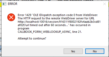

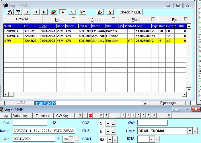

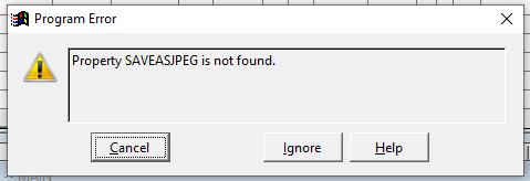

Just before installing the latest upgrade, I was having a problem logging new contacts. I then installed 10.0.11 and there is a slight improvement, but the problem still persists, but not always:
Upon logging a QSO, the Log window gets filled but not the browser window... I am not 100% sure what to call each window since you gave them both the same name: Log -- MAIN.
Sometimes the Browser window fills in after a second or two, sometimes not. If not, I then get an error message, which I click to ignore and all is ok. This takes considerable time, however. See attachments.
Please advise. Thanks, 73 and HNY.

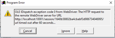

That error message is a mystery. LOGic is trying to navigate to http://localhost:10001/session/1640ba4.... I am not sure what feature would be doing this. Is the 1640ba4... part always the same? I can't find "localhost" anywhere in my code, so it must be something configurable. Are you running a local webcluster or telnet or anything like that?

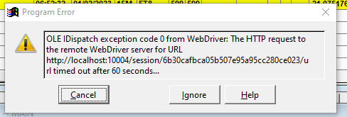

Please see attached error message with a new QSO. This time it said http://localhost:10004/session/6b30cafbca...
I am monitoring k7ar.net:7300 via telnet. I will change to another cluster just to see if that makes a difference.
The Log -- Main gets filled out with all information, including the callsign of the station worked. All information also shows up in the browser window EXCEPT the callsign. Then there is a delay (probably the 60 seconds noted in the error message) before the error message shows up. After I click on ignore, the callsign shows up in the browser window. During the delay, I get the error message: "This action cannot be completed..." if I click anywhere in the program.
Note: this does not happen with every QSO. Sometimes there is about a 2-5 second delay which is also not something I have seen before. It appears that anytime there is a callsign that has not been previously entered into the log, I get the delay and error message.
I am using QRZ Subscription which is up to date.
I closed the Telnet window with no change.
I closed the Spotlog with no change.
I am using Google Chrome Version 108.0.5359.125 (Official Build) (64-bit). Chromedriver108.exe is installed.
As mentioned before, this started BEFORE I installed the latest LOGic update and have installed it twice, which also resulted in rebooting the computer each time.
Most of the time I do not see these errors using WSJT-X, only when manually entering a new QSO. However, I have noticed that a new QRZ page is being opened (and stays open) every time I log a QSO which says "Chrome is being controlled by automated test software". This window opens on top of my LOGic screen sometimes.
Update: After all that testing and typing, I may have solved the problem, but it was something I never had to do before: I had to log in to the QRZ.com window that I mentioned above which says "Chrome is being controlled by automated test software". After doing that I no longer get the error messages, however there is still a bit of a delay before the browser window is updated...which may be attributable to the slow d/l speeds I am currently getting with my super old POS (that is Point of Sale) computer...

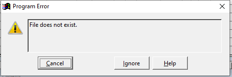

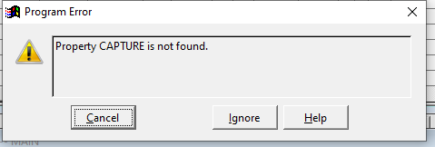

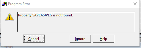

Restarted LOGic, now new error messages:
#6 Posted : Monday, January 2, 2023 5:23:29 PM(UTC)
