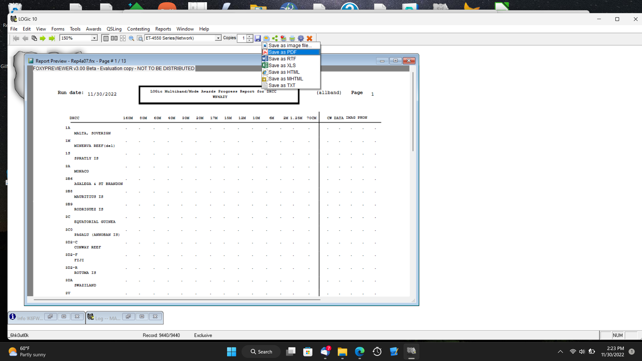

#6 Posted : Wednesday, November 30, 2022 11:23:12 AM(UTC)
I found a custom report previewer that seems to fix this problem, as well as some other nice features. For example, click the diskette icon to save as PDF etc. You can even search the report preview output.
There are some errors on HTML output, etc. But you get the results.
Will cost me a few bucks but think it will be worth it.
Let me know what you think.
http://gofile.me/5sBhf/jSuyLHAJl
Screenshot 2022-11-30 142425.png (409kb) downloaded 142 time(s).
