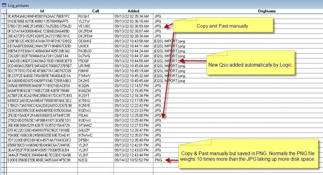

I finally found the corresponding names of the image files by loading the DBF relating to the eqsl.
In fact, the images downloaded with copy paste assume the JPG extension but only because I did not know that the transfer from eqsl takes place with PGN images.
Now as soon as I have time I will find a qso whose eqsl is not displayed in Logic and through the database I will discover the name of the file that Logic has assigned automatically and I will first try to check if the file is corrupt. If it is not corrupt, I will carry out the import procedure from Logic by entering the file name. We hope well. I will keep you informed of the result as soon as possible, thanks.

Hi Dennis take a look at this test I did.
Mauro
