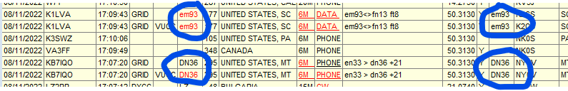

The Spot Log was showing a lot of grids needed when in actually they have been confirmed. I noticed that if the spotter has the grid prefix in lowercase LOGic treats it as NEEDED whereas if its in uppercase than its not.
The attached shows an example, the lowercase prefixed grid em63 has been confirmed but LOGic shows it as needed. The other grid DN36 is correct. Is the value reported in the grid column case sensitive ??
I have a TON of lowercase prefixed grids showing as needed so can provide more examples.

Your screen shot shows em93 & DN36. There is no EM63. OK, I guess when you say em63 you mean em93. So check to see if you need EM93 and EM93 VUCC.
Regardless, they shouldn't be showing up in lower-case. I tried to reproduce this by posting a test spot with the same comment em93<>fn13, and mine shows in upper-case. I am running LOGic with DX Summit and have a bunch of grids. They are all lower-case in the comment, but upper-case in the GRID column. I also did a test spot with upper-case in the comment, and the grid column was still upper case.
I would like to reproduce it so I can fix it.
What version of LOGic are you running? We changed the code that LOGic uses to extract grid squares and figure out which one corresponds to the station being spotted. It's been a while, but after we started switching to .Net.

Sorry for the typo. EM93 is confirmed for both instances. I have many others, attached is another screenshot of the SpotLog from earlier, notice every spot with a grid prefix in lowercase is showing as needed yet they all are confirmed.
Running the latest version, 10.0.8. DX Summit is feeding the spot log. I missed the change in LOGic where your grabing grids from the comment line of the spot, not sure why the need for that, regardless, the lowercase grid is certainly repeating here. I'll watch the spot log tonight and provide another snapshot tomorrow.
