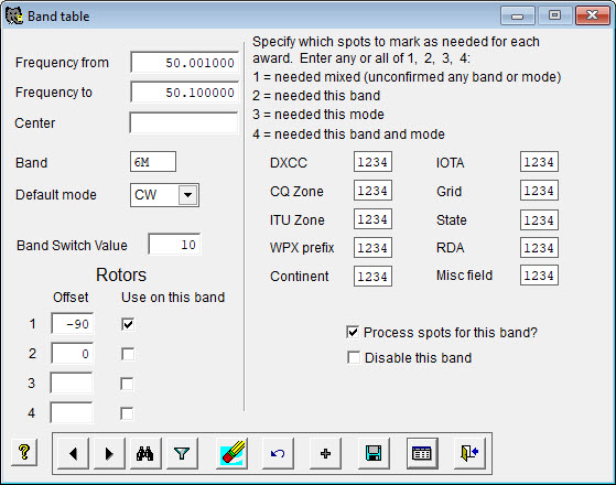

Could you help me add needed states on 6m regardless of mode? Your help will save me a ton of time :)

I've attached my band table for part of the 6M band. If you only care about 6M spots, remove the check from 'Process spots for this band?' from all other entries.
Don

LOGic already tracks and spots States. If 6M in the band column is red, it is needed for 6M.
Make sure LOGic is set up to track and spot 6M WAS. Go to tools/setup/bands. Make sure spotting and awards tracking are enabled for the 6M band segments. Go to tools/setup/log fields and make sure spotting and awards tracking are enabled for State. Finally, make sure the built-in callbook is loaded. Click Tools/Internet/Import FCC USA (K) callbook. This is necessary so that the spot log can determine the state for the spotted call.
