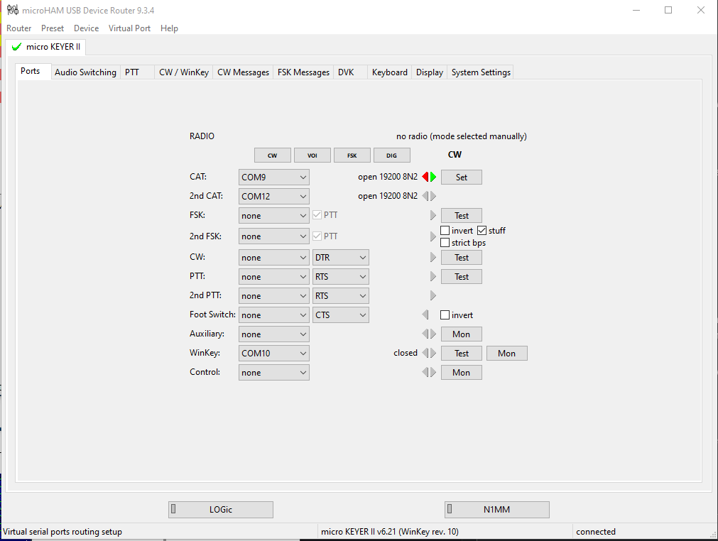

I "WAS" able to communicate via RS-232 to both LOGic and WSJT-X on different com ports simultaneously using the microHAM USB Device Router 9.3.4 in the past, but had a system "incident" when plugging in a USB camera that required me to redo the microHAM router settings (they were lost). Now, I can no longer communicate with LOGic and WSJT at the same time, even though on different ports. It is either one of the other. If I have WSJT running and I try to enable LOGic, I get an error "A timeout has occurred" and I can see on the microHAM control panel an attempt to communicate on the 2nd CAT port, but still no dice. I know this is not really a LOGic issue, but was hoping that someone else has been through this and knows the fix.

Well, I figured it out myself. There was a button in the configuration panel of the microHAM Device Router that wasn't configured like before. All working now. I can have both LOGic and WSJT running and on different CAT ports and either one can control the radio without shutting down the other. CONFIG NOW BACKED UP!
