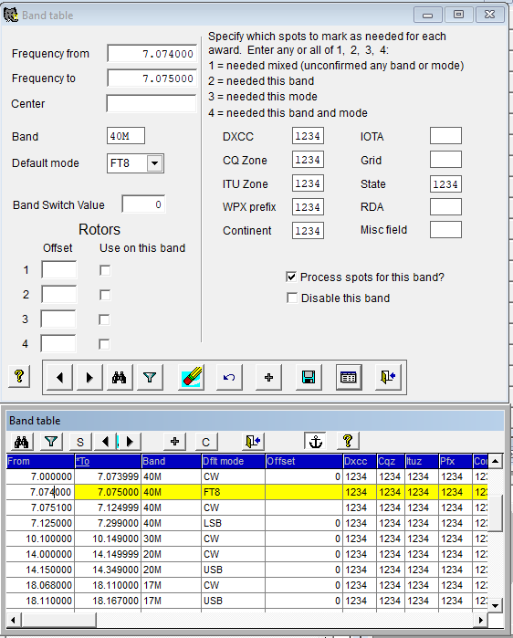

It doesn't seem to work, Dennis. Tell me what I'm doing wrong here.

#5 Posted : Thursday, January 27, 2022 3:15:31 PM(UTC)

What frequency are you testing with? It looks like it should log FT8 for 7.074.
Test by creating a test spot in the spotlog.

You're right guys, it does work...it turns out I have to restart LOGic for the changes to take effect. Thanks for your help!
