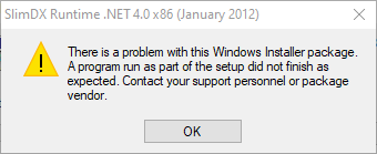

#1 Posted : Tuesday, January 11, 2022 9:03:44 AM(UTC)
Posts: 616
Thanks: 149 times
Just downloaded and installed new version 10.0.4 and the installer popped up a SlimDX Runtime Error saying it did not install as expected. LOGic did install and looked normal while launching, version is 10.0.4 and has the new features. Stability unknown but will be running all day.
v10.00.04-20220110-SlimDX Runtime Error.png (9kb) downloaded 151 time(s).
WN4AZY on 1/11/2022(UTC)
#2 Posted : Tuesday, January 11, 2022 9:10:20 PM(UTC)
Posts: 3,234
Thanks: 1125 times
Was thanked: 547 time(s) in 457 post(s)
The SlimDX handles spot announcement. There is no change to that or how it installs with this release. I have seen that error before. If it gives you any problems just reboot and reinstall 10.0.4.

#3 Posted : Tuesday, January 11, 2022 11:35:38 PM(UTC)
Posts: 616
Thanks: 149 times
Ok, thanks...
I tried another download/install after a reboot just in case a glitch occured but the result was the same with the installer popping up the same error. If anything starts acting abnormally I'll report back.
#4 Posted : Wednesday, January 12, 2022 3:57:18 PM(UTC)
Posts: 3,234
Thanks: 1125 times
I tried it here and no problems. Also no other complaints. So don't know what is going on.
You can download it here
http://distribution.hosenose.com/public/
and manually install it. See if you get the same error.'
What LOGic uses it for is audio spot announcement. Click the TEST button on the Announcement tab of the spot log.

#6 Posted : Thursday, January 13, 2022 12:21:26 AM(UTC)
Posts: 616
Thanks: 149 times
FYI - Ran the SlimDX installer and selected Repair (only other choice was Remove), sadly it doesn't report what it fixed but it did "Finish". Regardless, re-installed LOGic v10.0.4 and no more runtime error, so it did fix something.
Thanks again Dennis !!
73 de Brad, K8ZM
