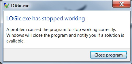

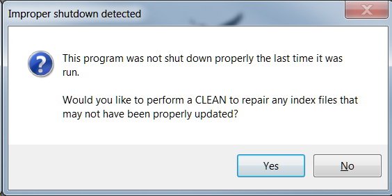

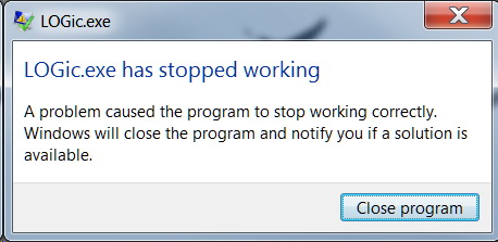

I tried using JTAlert 2.51.2 and LOGIC still crashes.
Logic Stopped working.jpg (34kb) downloaded 169 time(s).
Restart after error.jpg (39kb) downloaded 168 time(s).
