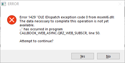

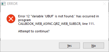

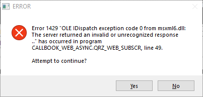

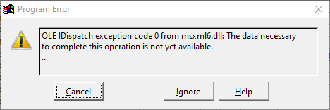

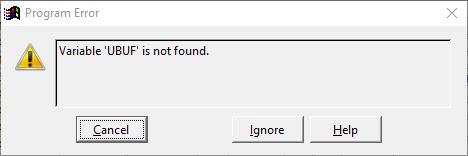

Since my callsign change and the new license file I have been getting errors on the very first attempt of doing a callsign lookup. Eventually after ignoring all the errors the lookup completes as normal. Subsequent lookups within the same session work fine with no errors being produced. I use QRZ Subscription and my login and password all were changed, LOGic does do the lookup after the errors are ignored but I suspect that maybe there is some rogue data possibly in LOGic that needs to be cleared. At first I thought it was a network issue with QRZ XML service but this occurs the first lookup in every new session of LOGic.

After launching LOGic this morning, the 1st look-up done again produced 5 errors, different from the previous but still related. Subsequent look-ups (same session of LOGic) were fine like previously and finished from QRZ Subscription but I only did a few.

I logged S9OK this afternoon and as soon as I entered the call, I got the same errors as Brad.
