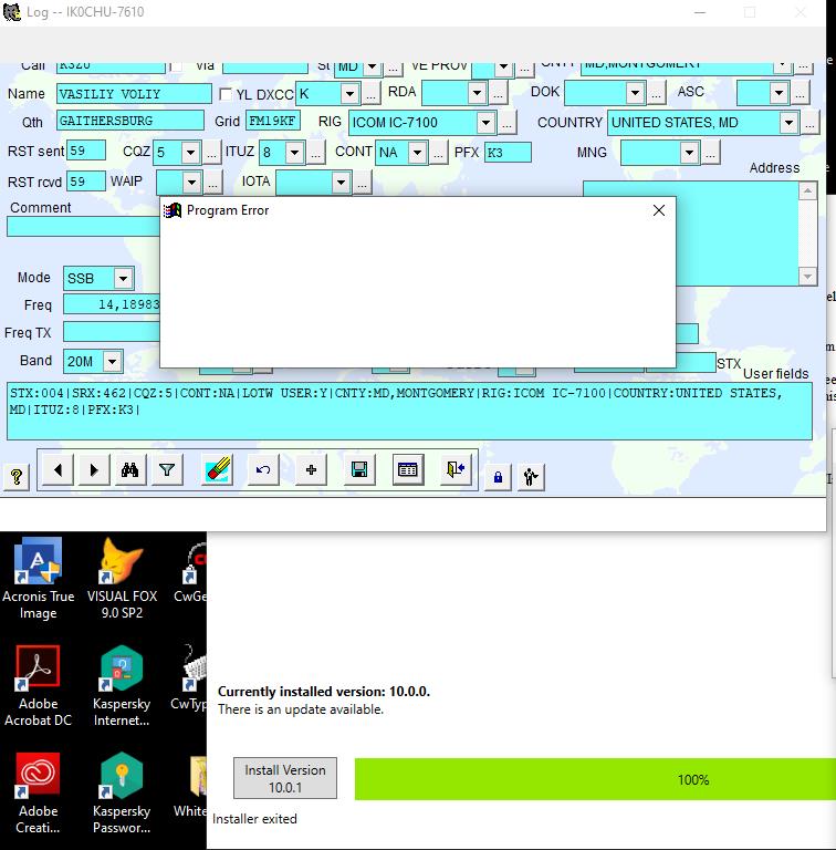

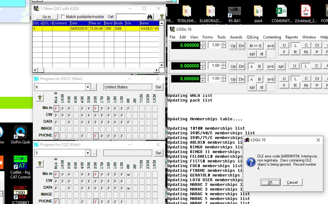

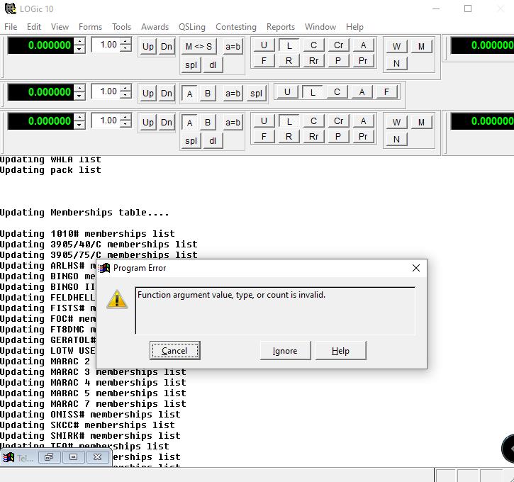

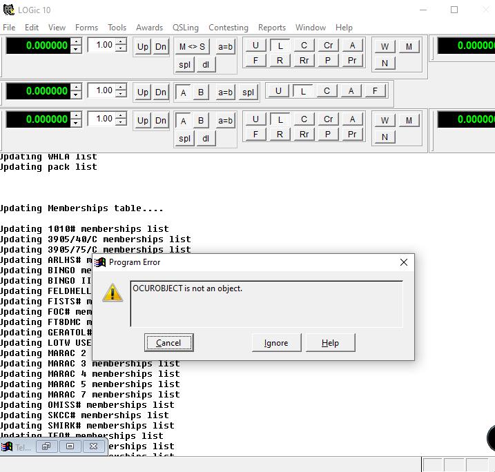

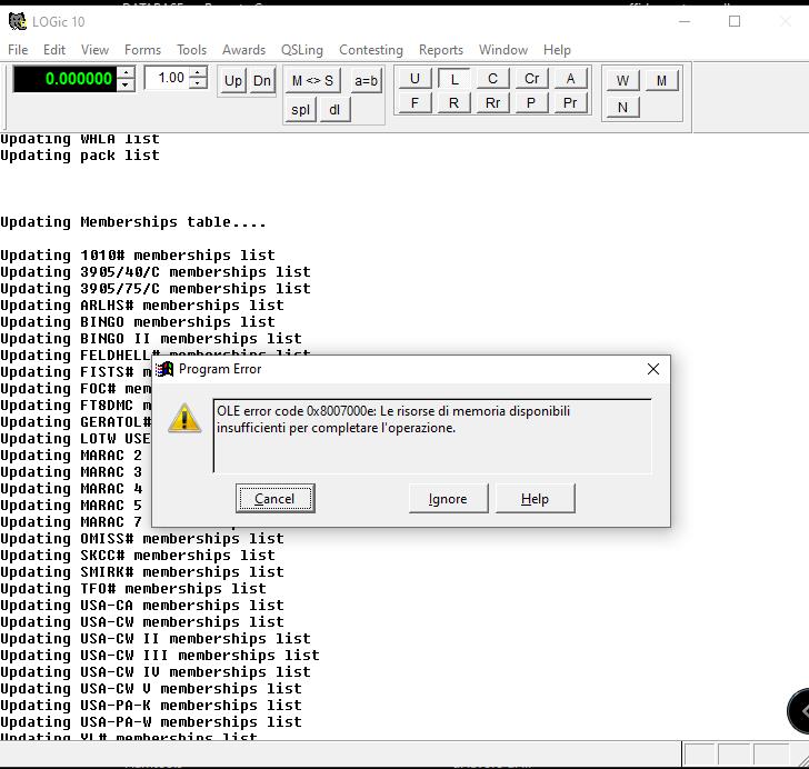

installing the new vwrsion i had many errors. The first after backup table list and at the end of list the program crashed. The reason was the memory full. (???)
CTRL+ALT+DEl to begin agn but the same process created many errors and press always ignore to continue but never changed and i decided to press cancel and another time CTRL+ALT+DEL.
Renunning the Logic the program starts with no problems but i dont know if is all OK.
I tried to reinstall the new version and all the things was the same. Look at some pictures of errors occurred, followinf the numerical progressiion, if can help you in the search for the reason of the problem.
Sorry but Im thinking to downgrade into 10.0.0 to be sure in the next future to manage my logbook like before.

The error of significance is the first one -- insufficient memory.
It looks like it crashed installing the new Memberships and Lists. Deselect that and see if you bypass the error. Or maybe the QSL list. Deselect that too.
At any rate, that error doesn't look like it would affect how LOGic runs.
I tried installing 10.0.1 with the lists and memberships and QSL, and no problems. You could try checkmarking RETAIN FILE AFTER INSTALLATION. Exit the updater then run LOGicUpdate10.0.1.exe manually by double-clicking it.

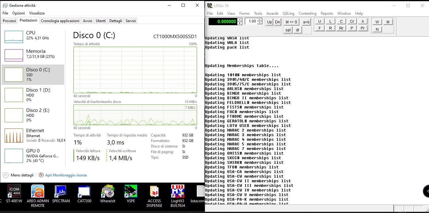

after 32 minutes I forced stop running program.
Here the situation of my computer before the stop.
Now go to sleep.
