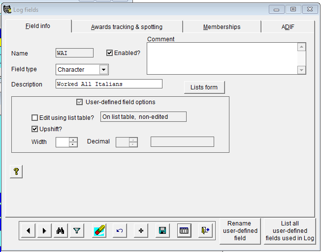

#3 Posted : Wednesday, September 8, 2021 7:49:40 PM(UTC)
Posts: 3,257
Hi Mauro:
The filter will show a count of all QSOs with any I or IS0 station. I can't see what you did to set up the Awards report, but it looks like you are on the right track. An awards report normally shows each value only once now matter how many times you work it.
Here is how I would do it: Set up a new award like the photos. Then you can do mixed, band, mode, etc. If you want to.
