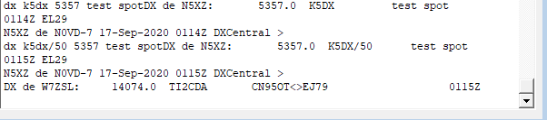

I just spotted a special event station K5DX/50 on the cluster, but it did not show up in the spot log. Any idea why? This is a Special Event Station for the Texas DX Society 50th Annivesary (I am also one of the operators) and I would like to get alerts when it is spotted. Wonder why it is getting filtered...? K5DX without the "/50" works fine...

It shows up in the spot log as K5DX but not K5DX/50. See attached. And I do have "SHOW ALL" checked.
2020.09.16 K5DX_50 spot.PNG (9kb) downloaded 128 time(s).
2020.09.16 K5DX_50 not in spot log.PNG (11kb) downloaded 139 time(s).

Looking in your first screen shot, I am not seeing the problem.
One is not in the correct format for a spot:
dx k5dx/50 5357 test spot
But there is one that is in the correct format:
DX de N5XZ: 5357.0 K5DX/50 test spot 0115Z EL29
LOGic does not expect that the line start with DX de N5XZ. This also works.
xxxxxDX de N5XZ: 5357.0 K5DX/50 test spot 0115Z EL29
This works too:
dx k5dx/50 text spotDX de N5XZ: 5357.0 K5DX/50 test spot 2 0115Z EL29
I tested these scenarios with LOGic's test spot feature on the Options page.
I suspect that the screen shot is not showing something. Some control characters or line breaks that are in the wrong place or something.
Try the Test Spot feature to make sure it is handling K5DX/50 for you also.
Be sure to checkmark NO PREFILTER. I thought it wasn't working at first, but I had a prefilter that stopped it.
