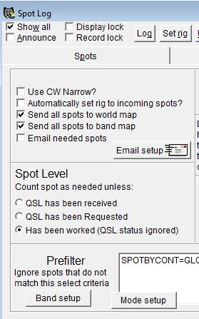

#7 Posted : Saturday, February 4, 2023 9:17:08 AM(UTC)
Hello,
Sorry, revisiting this Spot Log Callsign issue Sad
Stations that I've worked (and/or) confirmed are not showing up as green in the spot log. This happens a lot and often, I set my radio to the station only to find out that I worked that station already. I've attached my screenshots. The callsign in the spot log does not come up in green.
The second screenshot is my Spot Log settings.
Any thoughts what I'm doing wrong?
Spot Log Callsign color.JPG (123kb) downloaded 157 time(s).
Spot Log Setting.JPG (41kb) downloaded 156 time(s).
