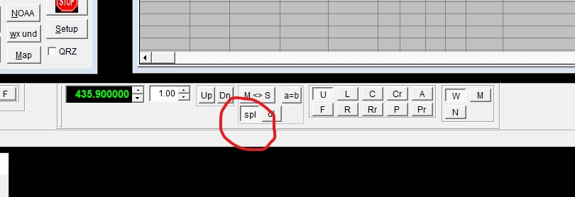

MAIN/SUB in SATELLITE mode. You probably have but check to be sure you have SPLIT set in LOGic rig control window. I attached pics of 9700 display in SATELLITE mode, LOGic rig control window for driver #48, and LOGic logform with test QSO logged in SATELLITE mode showing Tx Freq logged. You may see something in these that may help. I can give you any other settings you may need.

everything works now. There was a very simple thing that I didn't think of at all. Putting the split in 9700 does not affect the logic9, whereas, vice versa, clicking the SPLIT button on the Logic9 determines the activation also on the 9700. A small detail that was known but I forgot.
