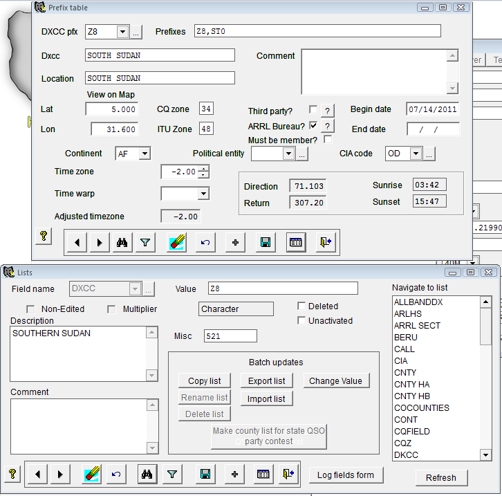

If you used your own prefix (something other than Z8) for Southern Sudan when the country became active, this is how to change to the official Z8 prefix.
This procedure will work regardless of what prefix you used for the new Southern Sudan in the interim between DXCC approval and assignment of official the prefix.
A word to the wise, a backup never hurts!
Make sure you have to 9.0.38 or later version of LOGic. Click on Tools/Setup/List of Valid Values.
Locate the new Southern Sudan record. Here is one way to do it: Click Filter (the funnel button). Next to MISC, enter 521 (this is the ARRL identifier for Southern Sudan). Click OK. Make sure that the Field Name is DXCC. Right-click the filter button to clear the filter. This is necessary for the next step to succeed.
Click the CHANGE VALUE button. Enter Z8 for the new value. This will update the Lists table and your log.
As of 9.0.49, an updated prefix table is included with the update. If you prefer to make the changes to the prefix table yourself, click Tools/Setup/Prefix. The CHANGE VALUE function of the Lists form changed the DXCC field, but you need to change the Prefixes list. Click the Get button (binoculars). Enter Z8 for DXCC. Add Z8 to the PREFIXES list. Our list had ST0,6T0,6U0 I changed it to Z8,ST0 (that is ST-ZERO, not ST-Oh). I figure that there are probably stations still using their interim ST0 calls that you might work.

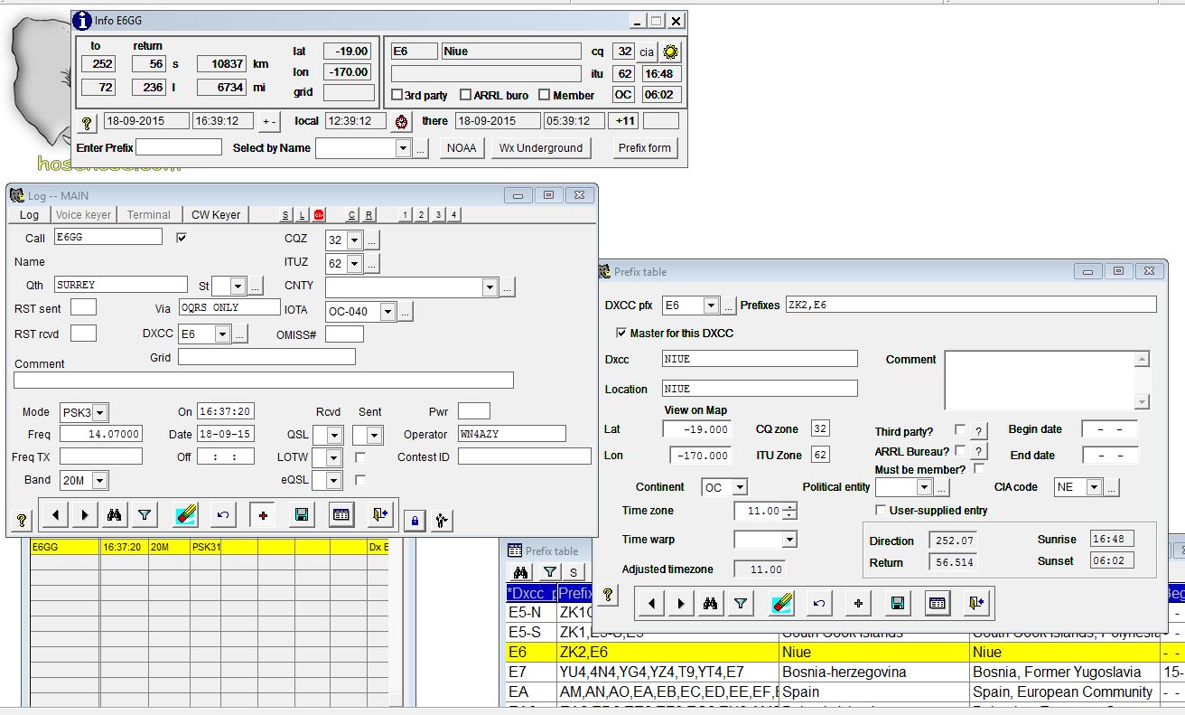

Can we revisit Niue? I just logged E6GG and nothing was filled in the DXCC field. I have 9.0.72 installed. I was confused as to whether I should check the box "update prefix table" so I didn't when I ran the install yesterday. So when this problem turned up I redid the install and checked the box. Still seems wrong. I manually filled in ZK2 for now but that is not right as I understand it. According to Clublog the correct prefix is E6:
For QSOs on 2015-09-17 21:05...
E6GG maps by prefix to NIUE
ADIF 188 [E6]
CQ Zone: 32 — Continent: OC
Location: -19.00°N -169.90°E
Beam heading: 250°
SR 17:11 / SS 05:15
Yes/no?
I see there was an update 3 years ago to fix this problem but seems like that fix should have been integrated by now.
Thanks.
Bill N5VR

LOGic definitely has E6 in the factory prefix table. Look in yours and see if it is there. See the attached screen shot.
#24 Posted : Friday, September 18, 2015 3:51:16 PM(UTC)
Posts: 214
I have the same problem as Bill. While E6 is in the table, if you filter the table for E6, nothing is found. Also, if you enter E6GG into the log, no DXCC is put into the record.
Bob

Same here, Dennis. Enter E6GG as a contact, and the DXCC field stays blank.

Hi Mauro. I don't think this solves the problem because Niue is E6, not ZK2 according to the ARRL countries list. Here is a copy/paste from DXCoffee:
"On August 3, the ITU updated its Table of International Call Sign Series to reflect a call sign change for Niue Island.The island will now have the entire E6 prefix block. Niue, an island approximately 1700 miles northeast of New Zealand, is a self-governing island nation that has been in free association with New Zealand since 1974. Prior to the change, the island used ZK2. Niue, which is about 1.5 times the size of Washington, DC, has a population of almost 600 people."
Fortunately my contacts, logged as ZK2, show up on LOTW as E6 now.
Bob

You're right, I have not solved the problem. With your help I proceeded to change my prefix table archive in Logic.
I do not understand why my archive wasn't updated. I probably made a mistake when I reinstalled the logic on my new Windows 10 system
Thank you.
#29 Posted : Saturday, September 19, 2015 4:56:16 PM(UTC)
Posts: 214
Does the correct DXCC come up when you enter E6GG? For me, I have the .72 update including the prefix table, but I still have the problem we've been discussing.
Bob

I have updated the table prefix manually and everything works perfectly.
I still had Niue with ZK2 as DXCC and do not understand why.
However now everything is ok. E6GG return E6 in DXCC field.
I'm using .72 and Win10 ... often i have problems starting Logic.

This is the version with E6 DXCC change
