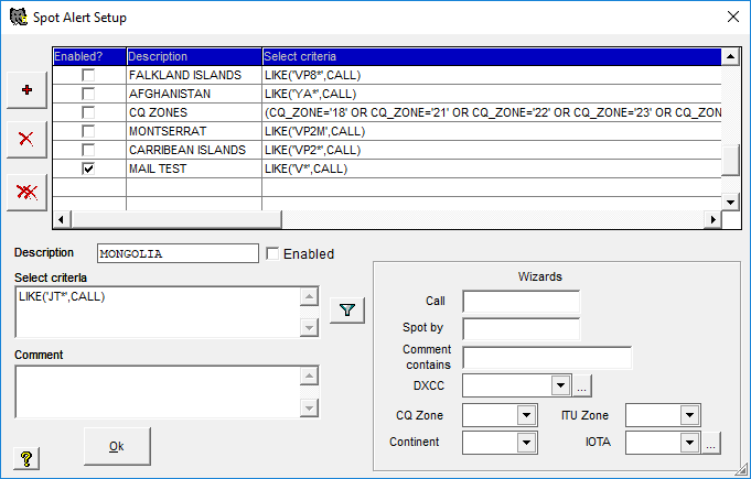

Observed behaviors since email alert activation. Screenshot files attached.
1 - Files Alerts setup 1 & 2 show my list of alerts. Note only MAIL TEST is enabled.
2 - File Alerts and telnet shows the alerts and the telnet activity.
3 - Files email 1 & 2 show the email I received.
4 - Files Spots 1, 2 & 3 show the spot log activity along with the telnet activity for the same period. These spots are for a one minute period. The spot log shows multiple entries for a single telnet spot.

#2 Posted : Sunday, November 25, 2018 1:05:57 PM(UTC)
Dave,
The reason you're seeing multiple spots are each one is for a different award that was setup in the Band Table. For example if you setup DXCC and CQZ and a station was spotted meeting those awards you'd see 2 spots. I see you have several awards setup.
Your telnet issue sounds to be something is hogging the CPU, take a look at the Task Manager and see what Processes is using the most??
