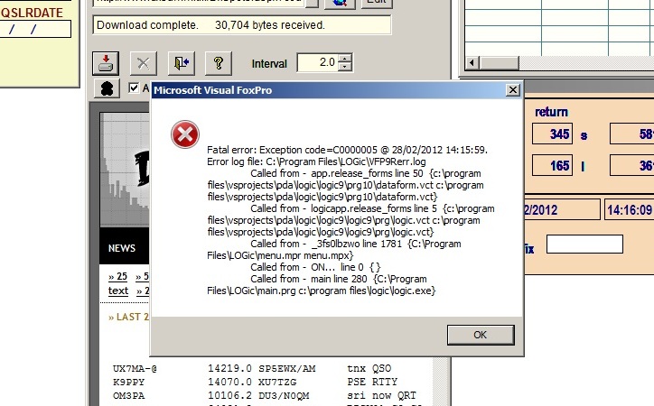

Hi Dennis.
I still have the error with the TS590. It won't work at a speed slower than 38400 baud.
When I try, it often crashes LOGic. I've attached pics of the error messages.
