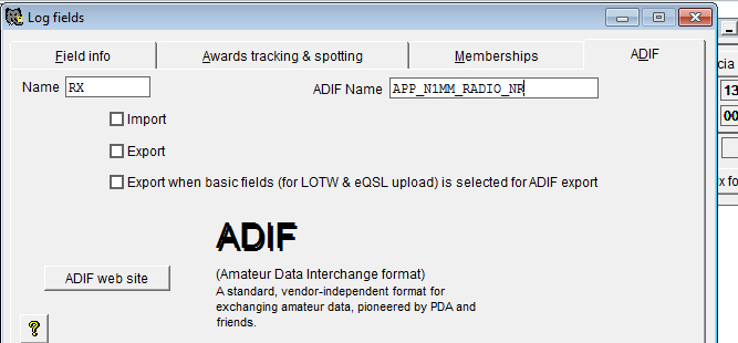

Using Logic, one can import different ADIF named fields moving the data into the Logic fields and user defined fields. One can translate from a external ADIF field name to a different Logic defined name. But, there are limits.
One can have a user field say RX, and import from a field in N1MM called APP_N1MM_RADIO_NR. In Logic8 the external field was limited in length, but I see in Logic9 it is now quite long.
The ADIF import/export limitations can be annoying. I agree, it would be great if we had a "table of relationships" for each field for each program. It would be great if all the logging programs used the same names, but I don't think that will ever happen. We should rejoice that Dennis (with a few others) was the initial creator of ADIF and attempted to address these problems.
If one wants to import ADIF data from several different logging programs - in may case HRD, N1MM, WINTEST, WRITELOG - one needs to carefully edit the ADIF definition in Logic for each import/export. Logic8 was limited in the external name length so I changed to using SED, AWK, PERL to edit the ADIF logs before/after import/export creating a common name which was translated by Logic into the Logic user fields. Much easier, and I have now automated the process and it takes only seconds after every contest for thousands of contest QSOs. This external editing is what you seem to do.
I think the intention was that in each Logging program there was a "translation" table so moving data would be simple. But many programs simply import/export their own name with no translation possible. Logic provides "translation" from one name to another. The limitations you are seeing are actually in the other programs - not Logic.
Logic9 has a much longer field for the external name so, given I mainly use N1MM for contesting, I will be moving to a direct import into Logic9 without the prior editing of the ADIF file. See attached image. But that will mean for an import from WinTest, I need to edit the name relationship in Logic - WinTest has no such "translation" like Logic. The same implies if I need to export ADIF data to other programs. The limitation is in the import of the other program.
