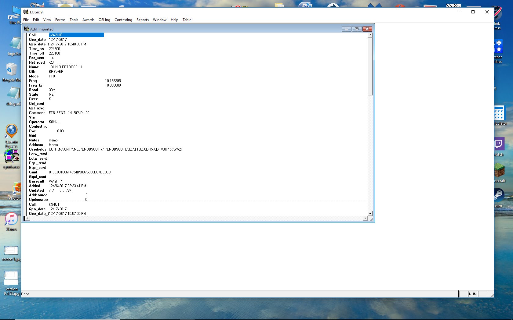

I added the screen shot as for the problem with ADIF. There are 2 screen shots 1 photos is version 9.1.1.23 and 2 is 9.1.1.26. as you can see the on import in #1 shows 30 for my power and #2 shows 00 this was done with the same import file from another logging program it may not be a big deal but when you import 10 to 30 files at a time at different power it take lots of time to go back change the power from 00 to what ever it maybe. The import all ways worked very good till version 9.1.1.24
Thanks you for the great program.
K0HKL 73, Keith

Ok, please post the ADIF file in question and I'll fix it. Or just paste a record or two in a message. The ADIF import was totally rewritten in .24 so we can interface to WJST etc., so I want to get this right.

Thanks. I fixed it. Get 9.1.27.
