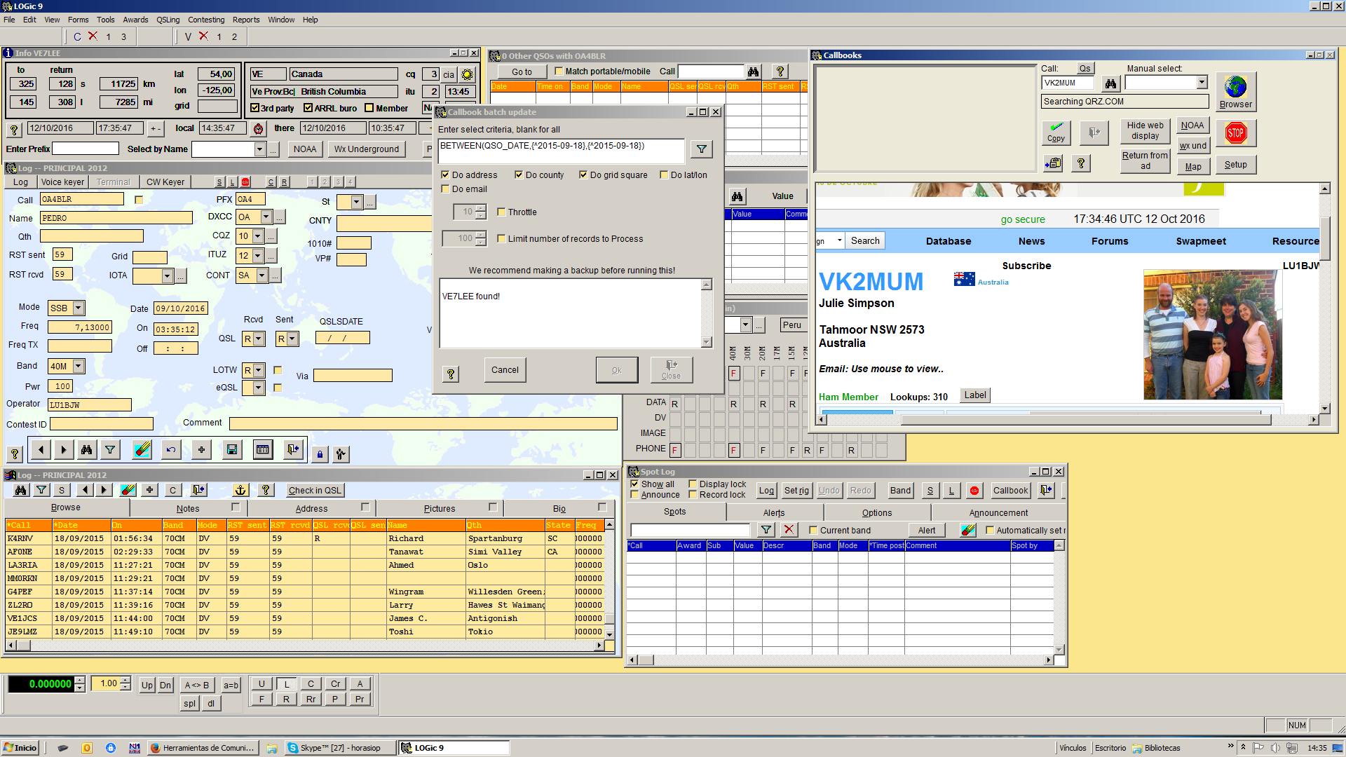

Changes: Change the operative system from XP to Windows 7 Ultimate. I used my Logic cd to install and then Y downloaded updates.
I overwrite several files, according to one of your posts here in the forum to obtain my personalized configuration.
My test:
I enable qrz.com. And the system start to look and when uses qrz.cm finds the results but stops and do continue with the search.
I attached an screenshot.[img=C:\Program Files (x86)\LOGic\PrintScreen121016.png" alt=""/>
thanks
Horacio
#8 Posted : Friday, October 14, 2016 8:50:33 AM(UTC)
The latest version is 9.1.4. Click Help/Check for updates.
If you log a QSO, does the QRZ.COM lookup complete and log the info?
