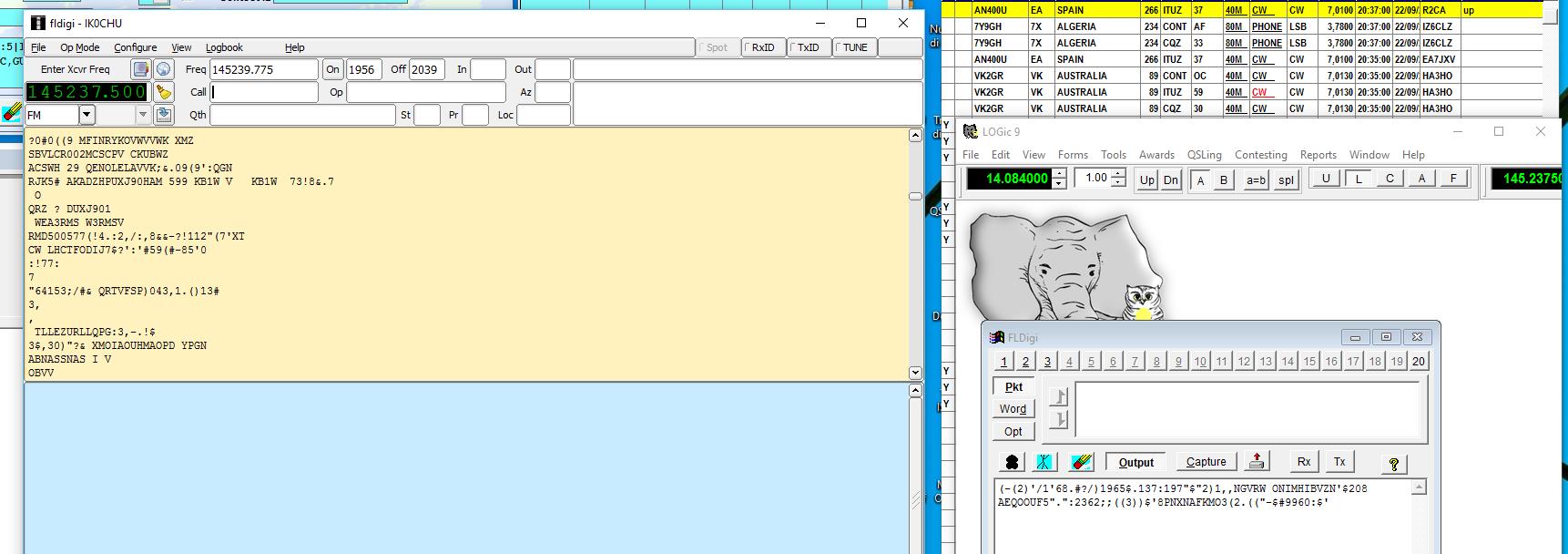

Hello Dennis ,
I usually use more radios linked to Logic. With Fldigi activated the working frequency is always that of the last connected radio (Two radios is the 2th, Three radios is the number 3). In the example of attached screenshots, to be able to use the RTTY with Fldigi in HF (radio1) I have to disable the V-U-SHF (radio2) otherwise by default it enables radio2 .
Did I do something wrong? Thank you.
73's Mauro IKØCHU

Sorry, it appears to be sending any radio frequency activity to FLDigi. I will fix it so it follows the radio assigned to the active log form.

Turned out to be an easy fix. The fix is in the latest 9.1.3 update. Let me know if any problems with it.
