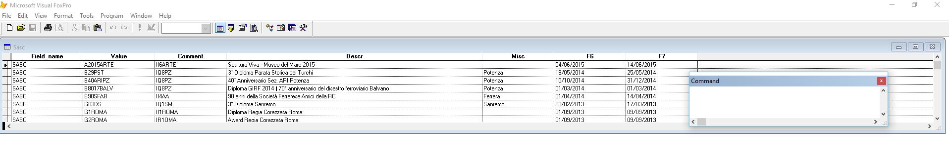

I know the documentation about about the problem and i have all the column header right (I think hi)
As you requested a few lines of data to insert in the list table are included in the screenshot attached.

Ok, sorry, my fault -- a bug. Here is the fixed LOGic.exe. Please replace your existing 9.0.89 with this. In interest of time, I didn't make a whole new install program.
Let me know if it works.
