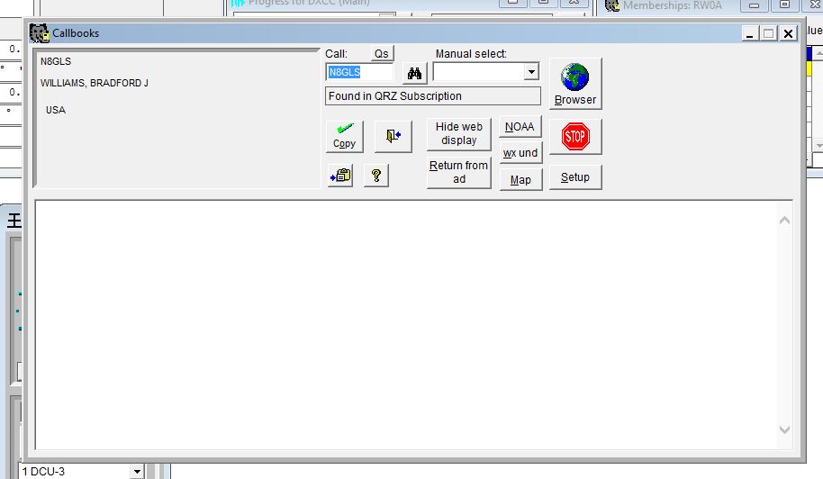

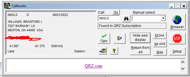

#11 Posted : Saturday, August 20, 2016 7:18:34 AM(UTC)
Posts: 627
Was thanked: 241 time(s) in 216 post(s)
I have the subscription but it doesn't work either, see post #5. There is no bio at all, its blank. The only thing showing in the left callbook window is name, call and country. No address, no grid, no county, no coordinates.....pretty much useless.
Attached are snippets of the callbook window with the subscription service enabled and the standard qrz "return from ad" window.
Any way to fix the subscription window ??
Thanks, de Brad, N8GLS

Ok, I don't know what is going on. Mine looks nothing like yours. Call me and I can log in and take a look.
There is a problem getting the Bio info back. I think I am following the instructions, but maybe not. I'll call Fred about it. Worst case I can just put a link to the QRZ.COM page for everybody.
PS the red splotch in the screen shot is where your email address was.

#15 Posted : Monday, August 22, 2016 9:32:45 PM(UTC)
Posts: 627
Ha.....had a hunch, proves the only stupid question is the one not asked...sorry it took me so long !!
Ok, so gave Fred some money for a decent dinner....hihi.
Maybe i'm doing something wrong but the subscription version is far worse to deal with than the non-subscription.
The upper callbook window displays all the station's info exactly the same as the non-subscription (except for the email addr).
The callbook web display doesn't display anything except a QRZ.com clickable icon, which when clicked on, launches a whole new IE window that takes me to qrz.com and displays the stations webpage. But performing another look-up requires you to close that window and then re-click the qrz.com icon all over again after the search is complete, i.e., the webpage doesn't follow the search look-up and has to be repeated for each and every search. The non-subscription displays the full webpage in the callbook window and follows whatever call I'm looking up without launching any other windows.....its all self contained in the callbook window.
Lastly the original "logging qso then up arrow locks in callbook screen" locks up the same way with the subscription version until you click Return from Ad.
I'm actually back using the non-subscription version and will avoid the up arrow in the logform window. The subscription version may be great for just looking at the upper callbook window info, but not having a "browser" in the callbook window that can follow the searches your doing is far to inefficient to be effective for me.
Brad, N8GLS

#17 Posted : Wednesday, August 24, 2016 7:55:55 PM(UTC)
Posts: 627
The way the callbook window works if a non-subscriber is ideal. The callbook browser is a winner, and being able to have it display the QRZ webpage as well as track with any callsign searched is, well, "Too Cool for the Room"!!! All this neat stuff happens within that window, no other windows, mouse clicks or navigation is required....its just the most efficient and actually genius on your part that it works this way.
The subscription version doesn't do this at all, you have to mouse click to do any search after the first and they subsequently launch all these windows clutering up my already stuffed screen, unless I close the first one, then, and again, mosuue click the QRZ.com to display the webpage for each and every lookup. So if I'm trying to work a contest (and trying to work it in SO2R mode) I don't have any screen area left, but even ignoring that, having to navigate and click through this is tedious to say the least. The non-subscription version is far superior.
See attached screen shots. The non-subscription.jpg shows the very nice and compact callbook window on the lower right with the callbook web browser displaying the W1AW QRZ webpage....nice !!!
The subscription.jpg shows the very large and screen consuming IE window right in the middle of my LOGic screen blocking everything, and it took a mouse click on the QRZ.com icon in the callbook browser window to even get that.....and every search will launch another IE window, and another......not so nice!!!!
So, yes, PLEASE make the subscription version look and function the same as the non-subscription version.
A million thanks for that !!
73, de Brad N8GLS
