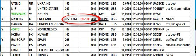

I read your answer on the spot log and I will answer about, thanks.
A few minutes ago I made QSO with MX0LDG by Lundy Island EU-120.
I logged the QSO using the LOG button from spotlog as you see on the screenshot.
The previous QSO with MX0LDG was from EU-011. It states that the IOTA field is among those who Logic must copy in the next QSO.
The field remained IOTA EU-011 despite the spotlog defined the IOTA field EU-120.
It's right or I made a mistake? Thank you.
73's de IKØCHU Mauro.

Thanks, I can reproduce that here. The COPY FROM PREVIOUS QSO is taking priority over what the spot log sends. I will fix it.
