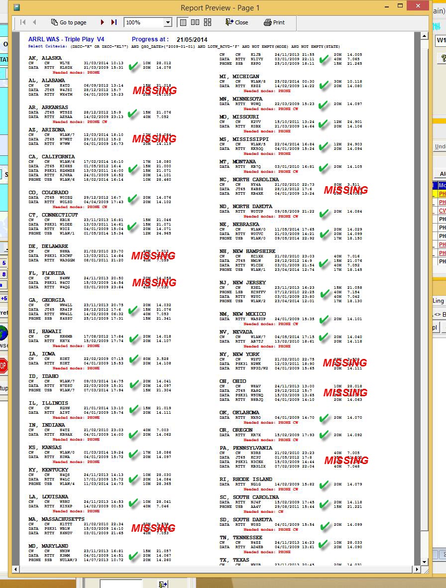

Late last night I finished V4 of the ARRL WAS - Triple Play report.
The report now displays the needed modes for each US State.
The "Select Criteria" for QSOs by default is now ...
(DXCC="K" OR DXCC="KL7") AND QSO_DATE>{^2009-01-01} AND LOTW_RCVD='Y' AND NOT EMPTY(MODE) AND NOT EMPTY(STATE)
I discovered many QSOs in my log that have the US STATE set - but are not K calls. Looking at the "qth,name,address data", I think this happened because the Callbook Batch Update updated the STATE for the US owner of the call.
I also discovered a mixture of QSOs with F, rather than the default Y, as the "received status" for LOTW. I used the usual Mass Change in Tools,Advanced,Database Commands to unify everything to "Y" for LOTW confirmed.
You may change the Select Criteria to anything you desire to check your progress, if, like me, you don't really intend to apply for the physical award.
To bring in QSOs confirmed by eQSL, or by a card, you can use the following ...
(DXCC="K" OR DXCC="KL7") AND QSO_DATE>{^2009-01-01} AND (LOTW_RCVD='Y' OR EQSL_RCVD="F" OR QSL_RCVD="F") AND NOT EMPTY(MODE) AND NOT EMPTY(STATE)
The report now looks like this ...

#15 Posted : Monday, May 19, 2014 4:48:13 AM(UTC)
Hello Peter,
thanks for your work.
I have tested the different versions and this is what I noticed.
Where a State has confirmed in lotw CW and RTTY modes, the missing phone is shown in red color perfectly.
Where a State has confirmed in LOTW the CW and other digital modes such as RTTY or PSK31 and JT65, the missing phone is not reported.
Concluding, the missing phone is not highlighted if digital mode confirmed in lotw is RTTY in addition to other digital modes.
If you feel it is not enough explanation I can send you some screenshots of the v3 and v4.
I specify that the check has been done on different reports and also occurred with the necessary filters in Logic9.
Sorry for the delay but I've been busy for two weekends to compete in fox hunting in 2 meters in ROMA and 80 meters in VITERBO hi ...
Thanks and 73's de IKØCHU Mauro

Thanks for testing the report. To check that I understand the problem ...
A missing PHONE mode for a State, is not being printed in red if there are QSOs reported for CW and data modes that include RTTY and other digital modes like JT65.
So far I cannot see what could be wrong in my code.
It would help if you could attach a copy of your MODES table to a reply to this post. You will find the MODES.DBF in the logdata folder in LOGic.
And yes, a screen image of the error part of the report would be of assistance.
Peter VK4IU

Can you please send some screen snaps of where you are seeing the problem.
Peter VK4IU

Starting from the conclusions that you have written or taking the MODES database operating correctly, I pulled out two reports of my archive.
I used the V3, which I think is very accurate in the results, and V4 which has the description of the missing MODES.
I used exactly the same selection criteria for equality of verification.
On the report V4 I have highlighted "MISSING" all the STATES where there is no refer of missing modes while others are perfectly highlighted (green check) with respect to the report version V3.
I hope I can be of help for a deeper analysis of your code.
