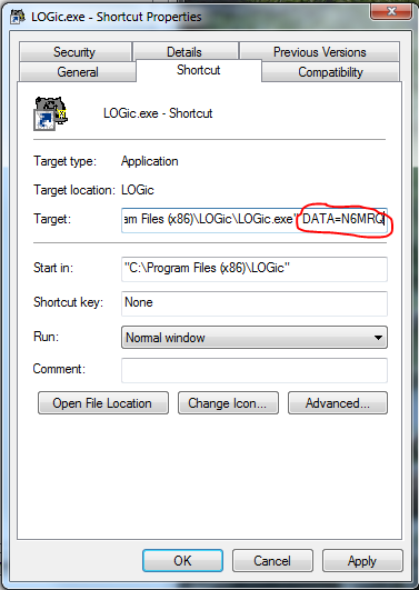

  • Now, you need to create a shortcut that you will click to access the new database you just created. Look for LOGic or LOGic.EXE. (LOGic 8 users look for LOGIC8 or LOGIC8.EXE). It should be in the folder already opened in the previous step. Right-click and select CREATE SHORTCUT. A new shortcut will be created. It will be named LOGIC SHORTCUT or SHORTCUT TO LOGIC or something like that, depending on your version of Windows and the Windows options in effect.
    Right-click your new shortcut and select Properties. In the Target field, enter a space followed by
    DATA=N6MRQ
    at the end of the line.
    This photograph illustrates. Add the text underlined in red.
    Click OK.
    Now, right-click the new shortcut again and select RENAME. Change the name to N6MRQ or LOGic for N6MRQ or whatever you want. Drag your new shortcut onto the desktop.
